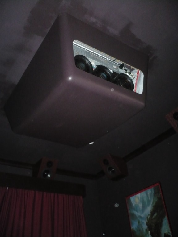

Yeah, those damn ugly hushboxes (paint marks aren't visible in to the eye).
 Filesize:  56.62 KB
 Viewed:  15767 Time(s)

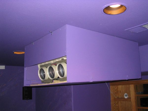

No fair, Mark. You should also include butt-ugly hushboxes like mine if you want an honest comparison. Laughing
(And trust me it looked worse in person than in this picture!)
FWIW that hbox was on my XG. I haven't needed it since going to the 8500 and I just tore it apart to recycle parts last week.
 Filesize:  28.5 KB
 Viewed:  15740 Time(s)
