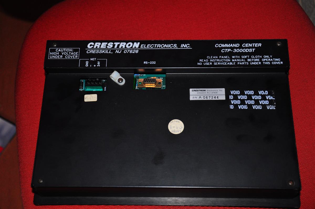

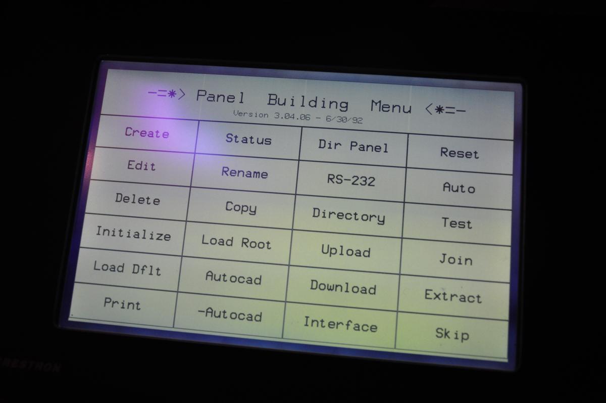

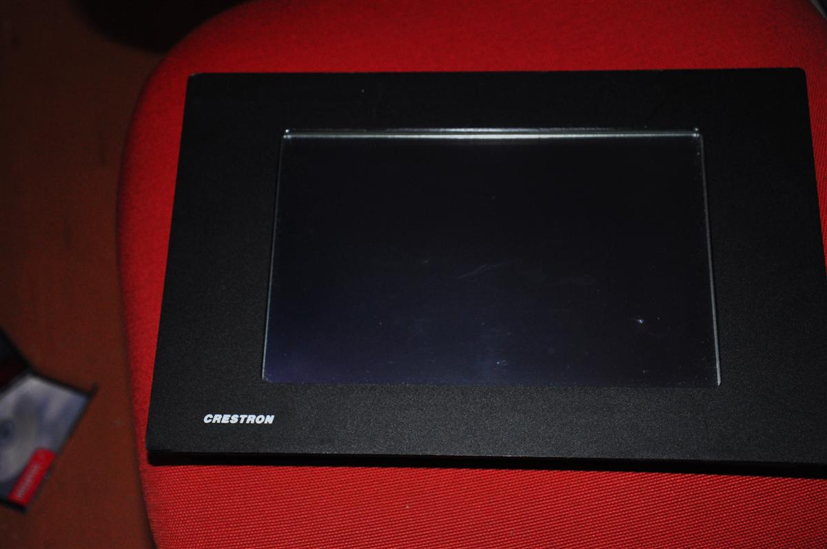

Hey guys, i'm pretty new to the forums but i noticed there was some crestron gear on here so i thought i may as well see if i can get some help.
I picked up this Crestron touch screen and i've seen it working with its controller (crestron cresnet IIMS) however the IIMS is now dead.... and i would really like to use the screen for anything, but what i mainly had in mind is for relay controls
i'm pretty upset that the main conroller is dead... and if i really am able to set it up then i'd concider buying a new one but i had a crack at the simpl stuff and i ended up with a headache >_>
Simply put all i'm after is a very easy way to switch some relays with a touch screen and also cheep, as this is the only touch screen i have i was wondering if someone could shed some light on how it talks to the main unit and if theres some way to use it without its other half.
Hell_hound
PS. i have attached the pictures
any help would REALLY be great Smile
screen turned on
 Filesize:  71.09 KB
 Viewed:  5978 Time(s)
back
 Filesize:  114.8 KB
 Viewed:  5974 Time(s)
front
 Filesize:  84.86 KB
 Viewed:  5973 Time(s)
Posted: Tue Jun 23, 2009 2:01 am    Post subject:
The touch panel is designed to send RS-232 commands to the controller. Unless you're an electrical engineer, it's really not practical to try to build or reverse engineer something to work with the touch panel... Even then, considering that you can probably find a replacement controller like the Cresnet IIMS for less than the price of a half-dozen relays alone... It just doesn't make sense to try to build something.

Hell_Hound, you have one of the oldest panels out there however that leaves some good news in that the configuration software is built in the prom of the panel and you DON'T have to have any Crestron software to program the screens. Pretty much you Define Buttons and each button gets a 3 digit number 000-999, when you touch that button the RS232 port will output Sxxx (xxx=the assigned number) and when you take your finger off you get a Rxxx. You will need something to monitor the RS232 and convert to drive signals for relays. ECRABB was right that just getting another CNMS would be as cheap as anything DIY and if you follow the Programming thread you can do much more!
