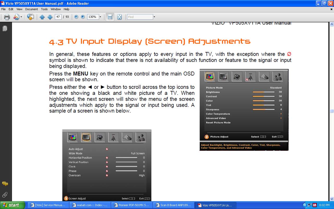

Posted: Wed Jun 17, 2009 12:06 am    Post subject:
LOL....I guess this is what your talking about. I'll see if I can locate a service manual for it but from what I have found, Vizio states there is no hidden service menu on their newer devices.......
 Filesize:  137.59 KB
 Viewed:  36 Time(s)
Posted: Wed Jun 17, 2009 11:04 am    Post subject:
That is it.
