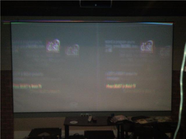

I have a NEC 10PG running RGBHV-VGA cable back to a Moome EXT-FULLHD through to a Dish Network DVR. I have tried copying input settings from one memory location to another, creating a new input, etc, and this "double image" split down the middle of the screen is the best I can get (picture attached). The one oddity I can see is the fact that the Moome box light over the "SEL" button is flickering red-green incessantly. I'm assuming this is not what it is supposed to be doing, but I can't find anything in the documentation that says what it means.
Thanks in advance for any configuration ideas!

I now have a single image after resetting jumper #5 and re"SEL"ing the unit. Now I have a problem with the PJ holding a convergence. If I power off the projector and restart it, I get the "INCOMPATIBLE MATCH!! CHECK INPUT LIST." error message and I have to reconverge. I'm assuming that this is related to the input setup, but I'm not sure how to address it.
Any help out there?

when yo get the box? you can send it back for software upgrade~

did you press the Store botton on the remote to save adjusted alignment value in a new input entry?
