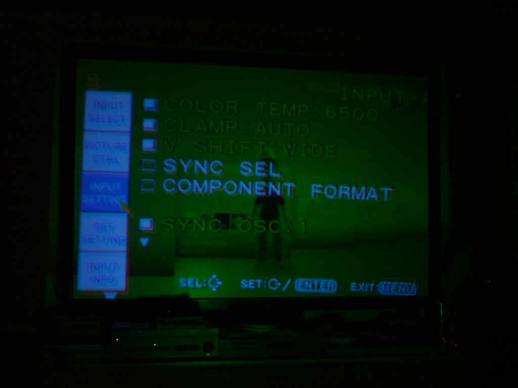

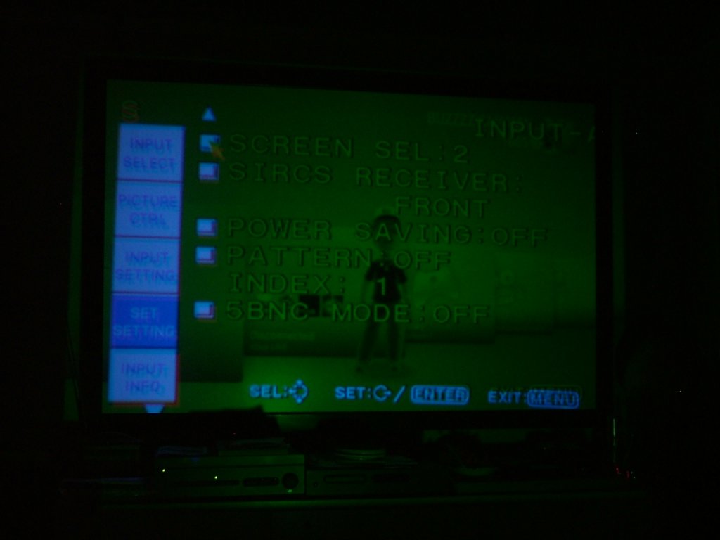

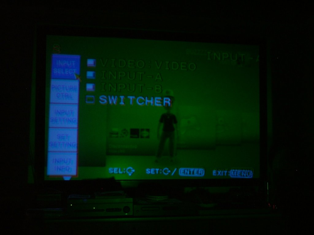

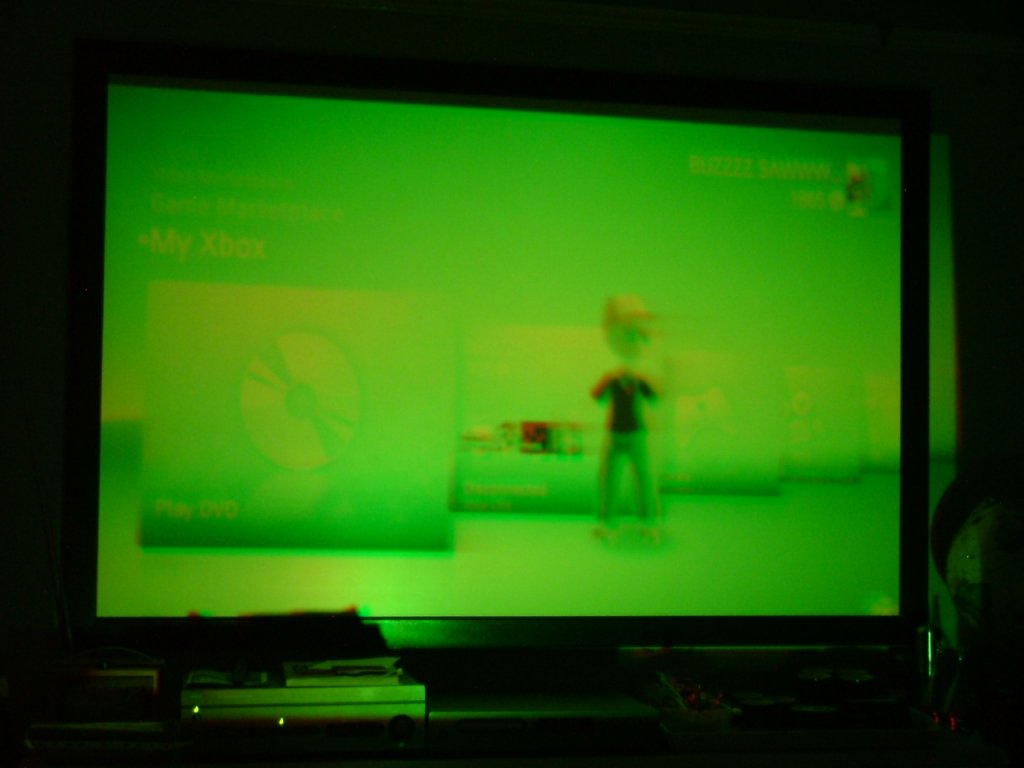

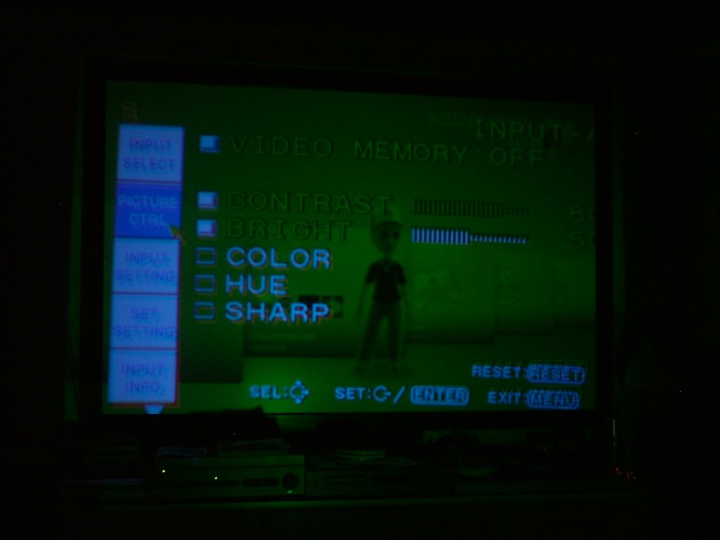

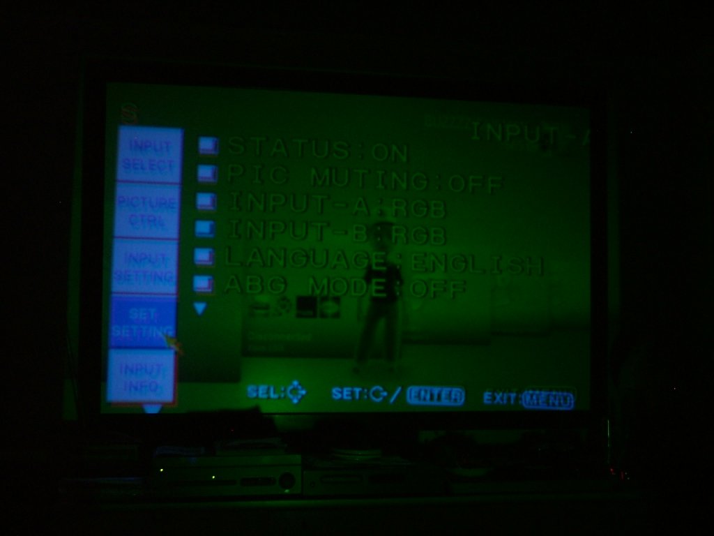

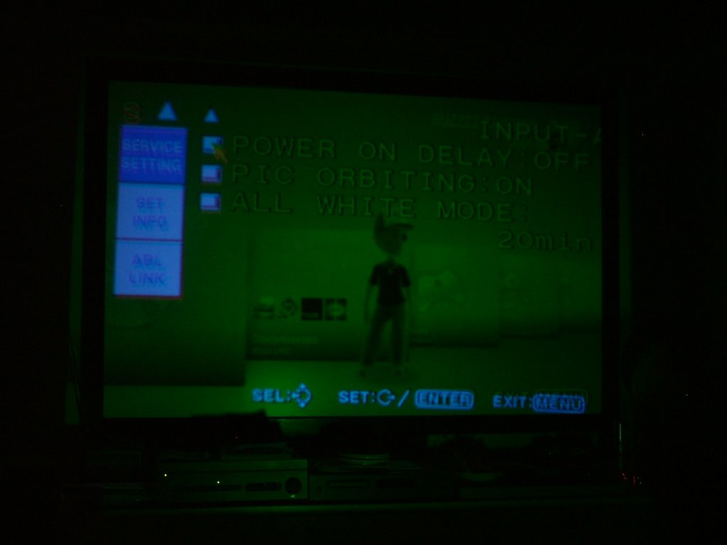

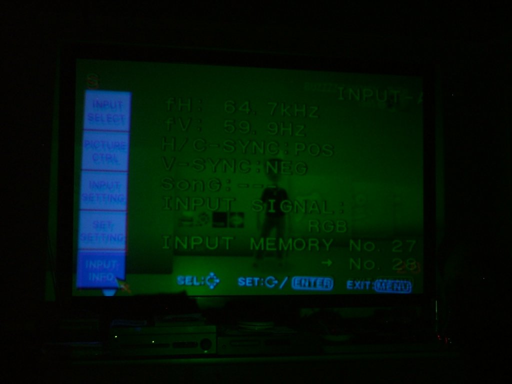

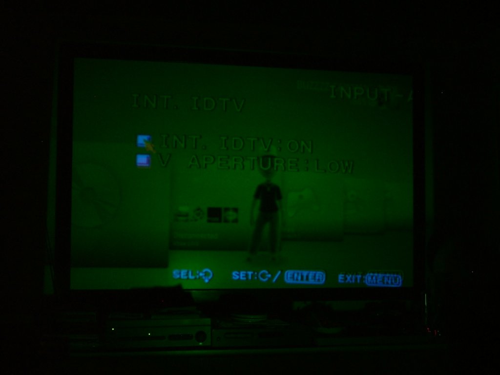

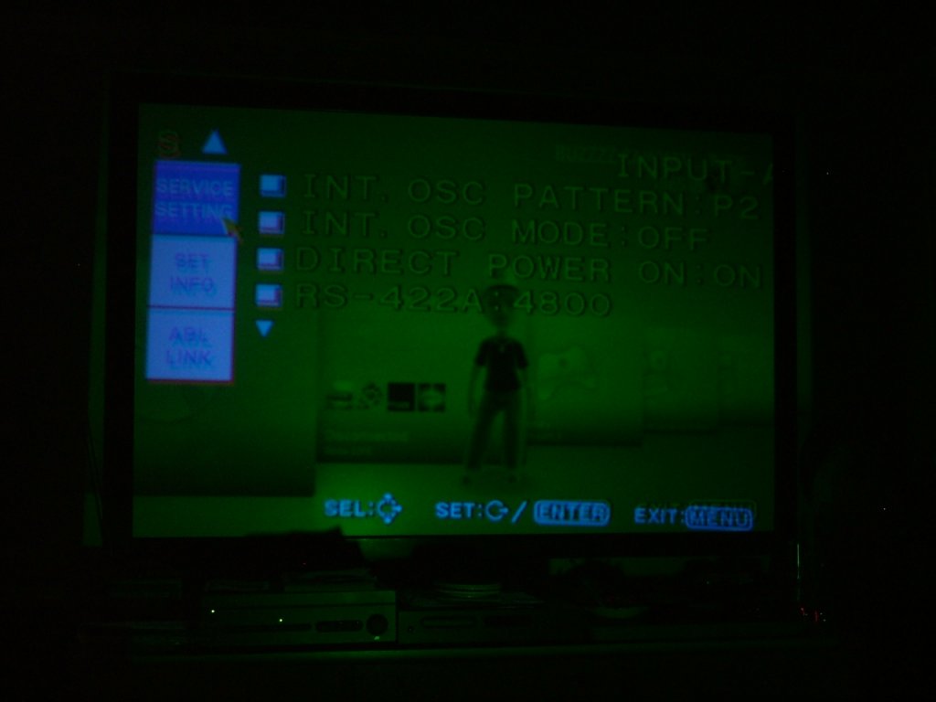

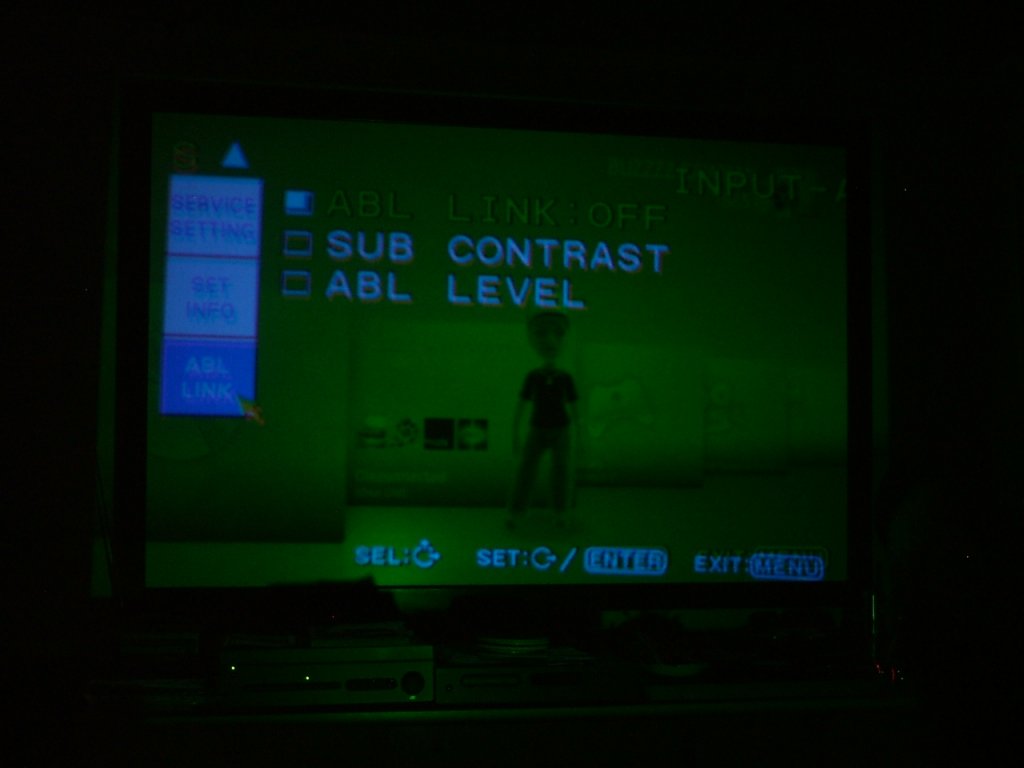

These are some pic's of my projector and how it is set up i hope yu can tell me where i'm going wrong!
cheers

From the screen shots you posted, you are sending your D50 1080P(as in progressive) which is over the max 64kHz horizontal scan rate your projector is capable of displaying. You need to change the output of your video card to a lower resolution, like 1280x720p, or, if you have the option, choose 1080i(called 30Hz by some video cards, because its an interlaced resolution).

According to the specifications for your projector, it is only capable of scanning to an absolute maximum of 64kHz, and from your screen shots, you are exceeding that by .7kHz. Stop using that resolution immediately before you damage something.
Also from your screen shots you can see that all three tubes are working, just not displaying the image completely.
Change your HTPC's resolution to 1280x720p if it dosen't allow you to choose 1080i(interlaced).

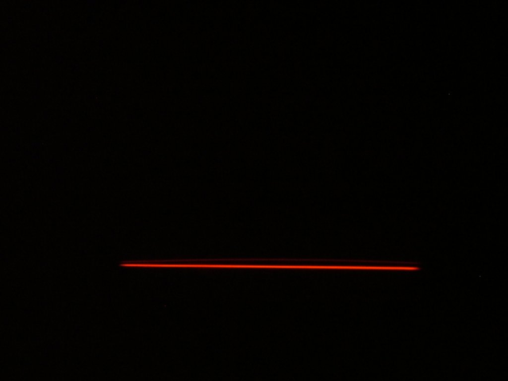

I have now set the res lower and am getting red on constant and green on then flickering and blue not on. Here is a pic.
I also havenotice that when there is no input signal i get a wierd line on the bottom of the red and green tube and i don't know what it is or what it will do if i leave as is. Any idea?
I'm planning on cleaning the projector tomorrow as i got it in a bit of a state with a lot of dust and dirt in it which could be causing the problem, how is the best way to clean a crt projector?
Cheers
Here are the pics
