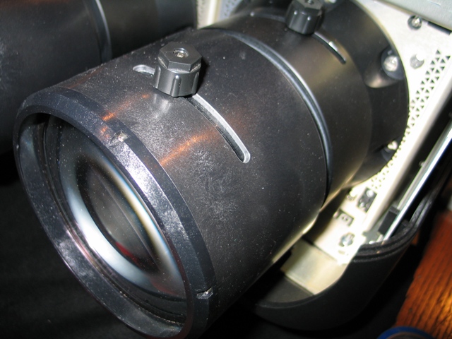

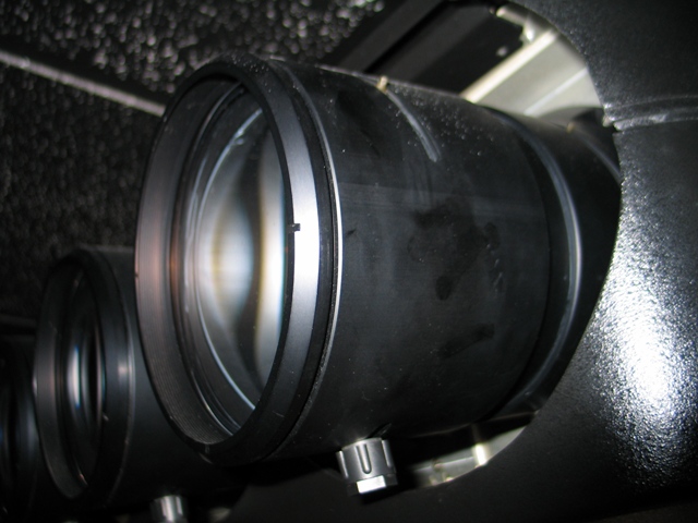

I think this is a very confusing topic as I don't think Barco (or Runco) has been consistent over the years as to what they fitted to the Cine9.
I have 2 Runco DTV-1200's, one built in 2001 and the other in 2004, and they have different lenses, so Barco didn't always fit the same lens to the DTV-1200's.
The first picture is of the 2004 DTV-1200 lens:
The 2nd picture is of the 2001 DTV-1200 lens:
Subjectively, I believe the 2004 lens is somewhat sharper and holds corner focus slightly better. I don't know what the lenses are. I was told the 2001 lenses are HD120's. That being so, what are the 2004 lenses? HDQ900's? I don't know.
I even read somewhere that the HD120's were identical to HDQ900's. I don't believe that is true, but it shows just how confusing this topic is.

2004 lens

2001 lens

Hi Bob,
Nice pics = looks like your 2004 has the HFQ900 with the GRP outer barrels.
When we demo'd the dtv-1200 here with both sets of lenses, it seemed to both of us that
the HD120's had slightly better "intra-scene" contrast. It would be interesting
to see the side-by-side comparison with perfectly matched PJ's....
