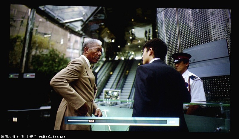

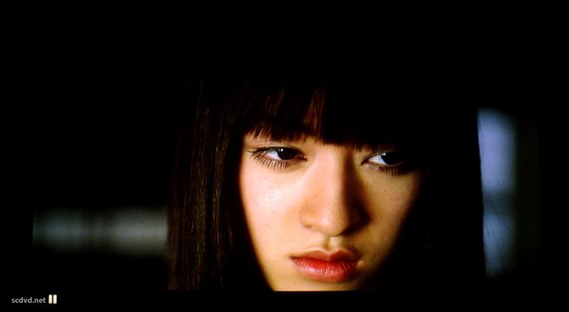

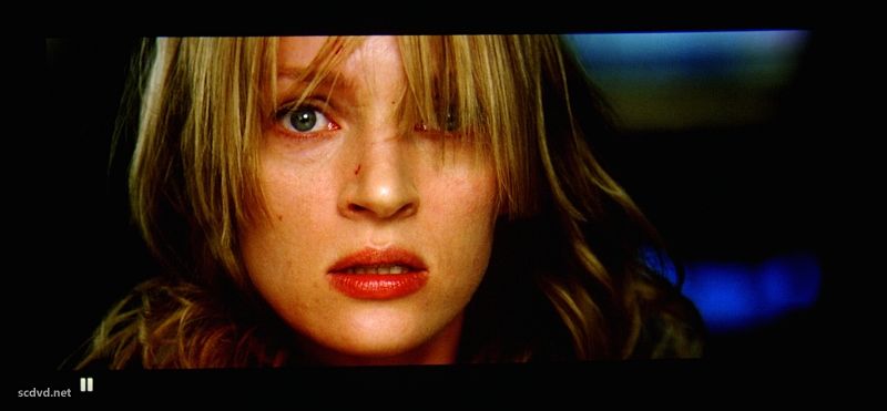

i just bought a 7599 hour BARCO 1209/2,it's great,and i feel 1080p@60hz is more sharp than 1080i in my geer,does is it nomal?
here are some screen shots.
