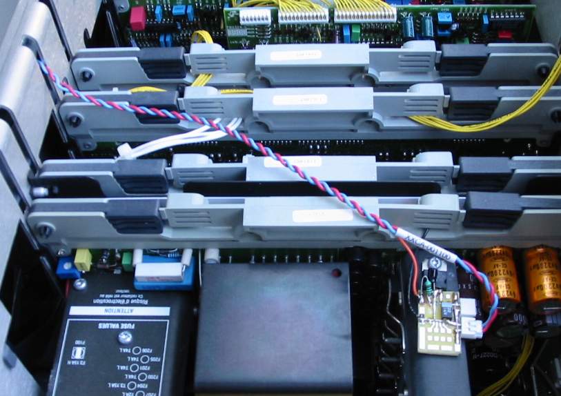

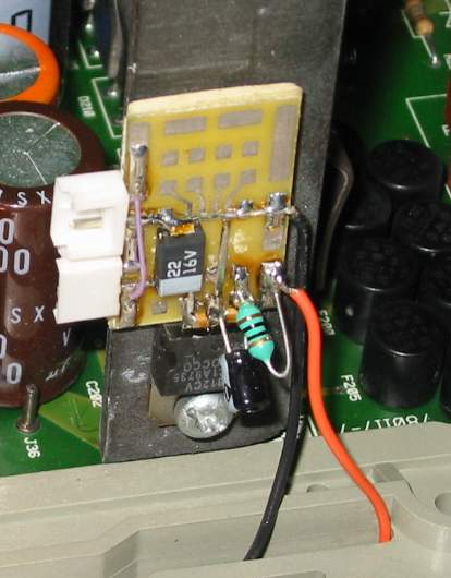

Mine has this in it.
 Filesize:  63.71 KB
 Viewed:  2957 Time(s)
 Filesize:  28.71 KB

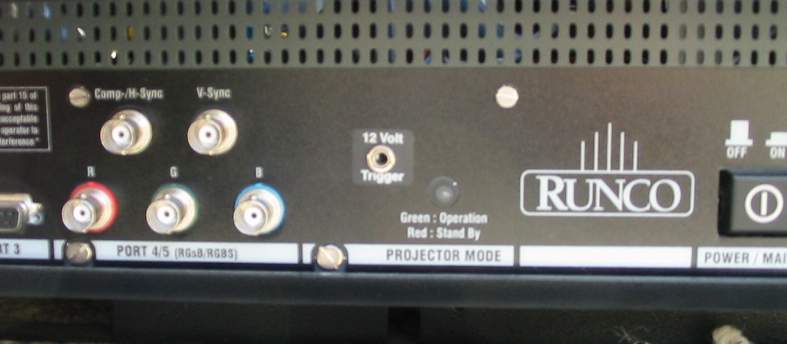

I bet Curt does.
Runco put a little jack in the back of the pj.
 Filesize:  27.08 KB
 Viewed:  2946 Time(s)

I should have a Runco SMPS here if you want to go that route. I think Runco simply tacks off the +17 volt line, and regulates the 17 volts down to 12, along with a protection resistor.
According to Runco, that board must be worth about $5K back when the set was new...Wink
