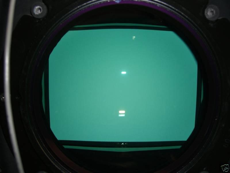

I am currently looking at a Sony 1292. The seller tells me that "the green tube has a circular burn in".

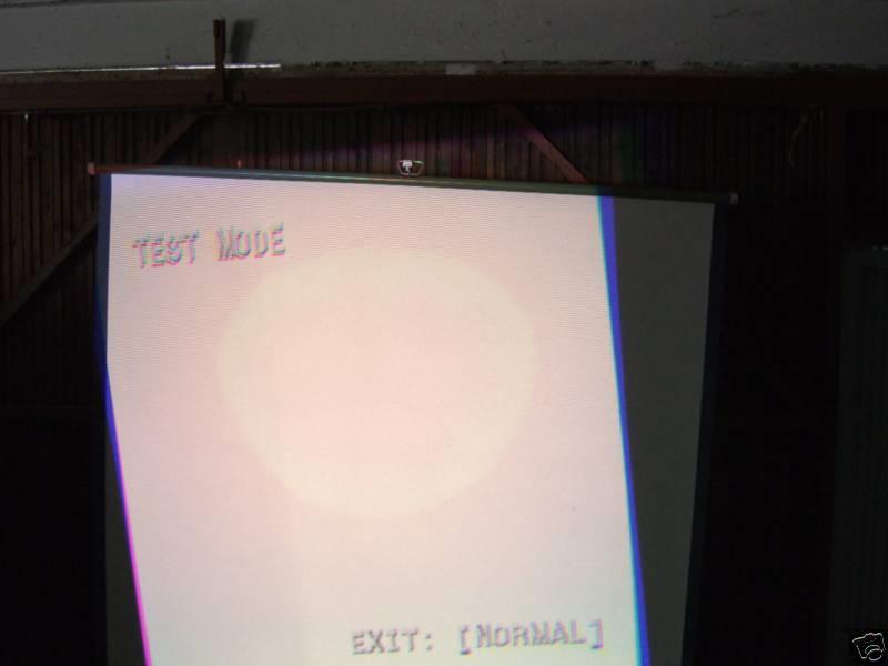

In the two pictures below I can see absolutley nothing on the tube face, but there is a strange circle in the projected image.
Does anybody have an idea, what this could be?

Yes, that is phosphor wear. Too light to be seen on the tube face, but visible on the screen. Sad

Hmm, too bad.
This seems to be a very strange wear pattern to me. I wonder what was projected to cause such a pattern. Especially since, according to the seller, there are only 900 hours on the tubes.
Are green tubes for the 1292 hard to find?

Posted: Fri May 15, 2009 1:42 pm    Post subject:
Not it's not Curt.
Pay attention.
That is the dreaded 1292 Phosphur Delamination ring.
The tube is dead.
But it's C element is valuable - don't let it get discarded.
And yes, 1292 greens are moderately hard to find. Not impossible, but because of the phosphur delamination issue, among other things, they are a bit rare.

Wow, you really think that's tube wear? I've never seen a tube that shows that much difference on the screen and and have no visible wear on the tube. Could this be a problem with the lense. I would try swapping around the lenses between the tubes to see if the problem follows the lense.

Interesting, I have not seen delamination like that before. I've seen two delaminations on Sony green tubes, both had actual peeling back of the phosphor, not the way it shows in the above image.
But good to know. Smile
I have however had a number of tubes where the phosphor looks minty to the eye as well as to the camera, but you'd see it on an all white field.

I'm surprised nobody mentioned this... If you look at the "screenshot" (heh heh)... The big circle shows a predominance of green or blue-green or a lack of red... That can only mean one of two things: 1) The green tube is burnt around the outsides with a big circle of unused/less-worn phosphor in the middle - which makes no sense, of course (and the photo of the green tube verifies), or 2) The RED tube is the one with the problem.
The latter would be my guess. I'd like to see a photo of the red tube.
HA! You are correct. We need to see a photo of the red tube. A red tube will certainly be easier to find than a green... at least I would think.

I asked myself the same question.
Well, I have pictures of the other tubes (not very good ones), but there is nothing to be seen on them

Turn the brightness and contrast down, Remove the lenses. Do you see anything on the tube face that would account for this while projecting a full White image ?
Posted: Fri May 15, 2009 7:51 pm    Post subject:
Its a water spot on the lens........... Laughing
