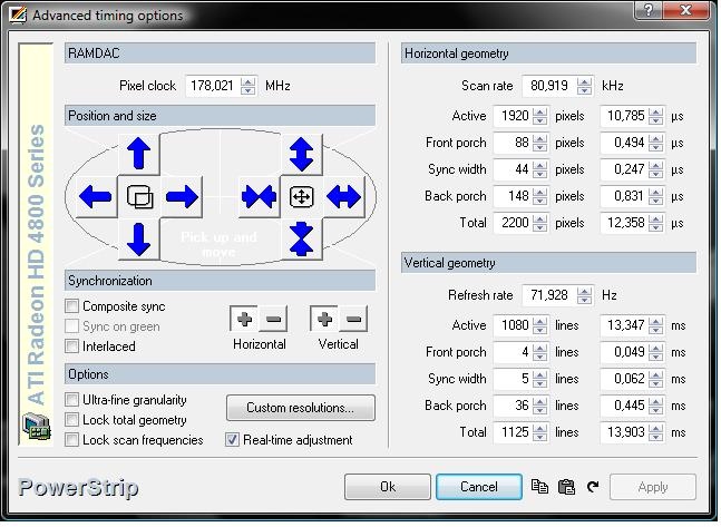

Posted: Fri May 15, 2009 3:20 pm    Post subject:
Elaine Benes wrote:
Can you let me know *how* exactly you get that working ?
What video card do you use ? Do you have to use Powerstrip ? If so, what timings do you use ?
Was it difficult to get working ?
Really, I've never had ANY success getting a Moome to show 1080p 72Hz...
I use a Radeon 4850 and Powerstrip, and the overscan function in the ATI driver, without that, I couldn't get the image to fill all the raster.
I didn't do anything special to get it to show 1080p@72, I set PS to the standard 1080p@60 and changed that to 72 Hz, and it worked from the start.
