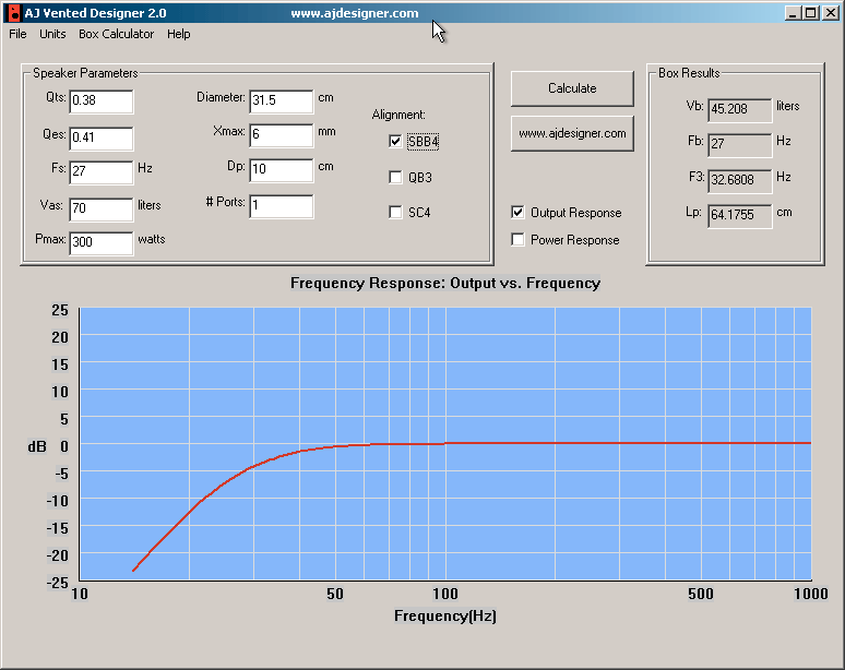

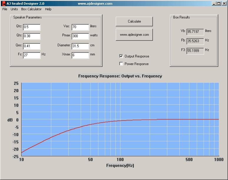

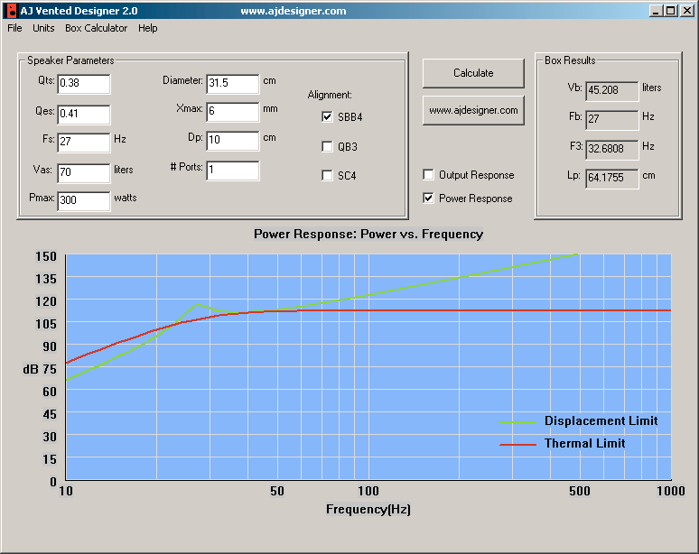

So, would anybody want to help me work through a few designs? I downloaded AJ Vented and Sealed Designer apps, and plugged the numbers in, and... Not sure what to think. I could use some input. I'll attach the screen shots of the graphs. Anyway, if any of you guys that are up on sub building could take a look, give me some input, and maybe bat around a few ideas with me... I'd appreciate it!
Posted: Tue Apr 28, 2009 8:24 am    Post subject:
Ported

 Filesize:  21.67 KB
 Viewed:  13871 Time(s)
Posted: Tue Apr 28, 2009 8:25 am    Post subject:
Sealed
 Filesize:  20.67 KB
 Viewed:  13869 Time(s)

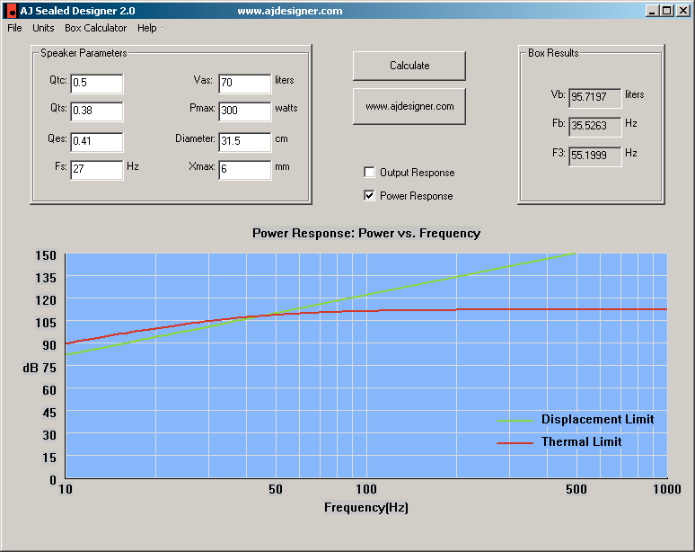

 Filesize:  21 KB
 Viewed:  13870 Time(s)
Posted: Tue Apr 28, 2009 8:32 am    Post subject:
The sealed looks pretty good to me... 95L, which is just under 3.5 cuft. Looks like an amp with about a 3dB boost would give me usable output down to the 18-20hz ballpark, yes?
The 3dB point is about 60Hz. Ordinarily I'd say that means you wouldn't see much at 20Hz, but probably you wouldn't feed this thing much above 80Hz or so? So maybe you'd get some noticeable output at 20Hz, but I wouldn't think much. But I'm no speaker designer, so I could be completely off-base...

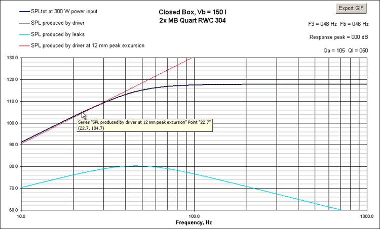

I think you're right, Gary. -3dB is up around 50hz. I was looking at the power response curve, and it makes it look much better than it really was. It was 3:30am when I was doing that and I shouldn't have been trying to do anything that required any focus or logic. I think I was on auto pilot.
I played around with the numbers a few more minutes in Unibox and I can't seem to get much better low-end response than about -4dB @ 40hz. I do have great output using two drivers and 300w... 117dB up at @ 50hz. Sweet! Here's a question, though: If you look at the response, I'm getting almost 105db @ 22hz, and the -3dB point from there is about 18-19hz... That's not counting room gain, of course... Could/would Audyssey EQ apply a slope to to the 20-80 hz range to give me nearly flat response from 18-80? If so, one of these two-driver subs would be able to keep up with my mains to nearly reference level... Which, is exactly what I'm looking for. This is a 105L (3.7 ft^3) box, with a Qtc of .707 and Fb of 51hz.
If Audyssey can apply a negative slope to cut the upper frequencies, then a second identical sub should give me flat response to below 18hz. Of course, at nearly 4 cuft, each one would be the size of an under-counter dorm fridge... But, what do I care? It's a dedicated theater! It's all about the experience!
Might I be getting close to something usable, here or am I off base?
