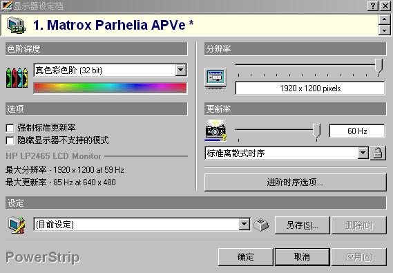

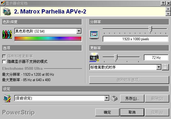

PowerStrip 3.84
1920*1080@72
MATROX APVE video card
133" 16:9 screen
Marquee 8500 Ultra with 3000 working hours

Posted: Tue Apr 21, 2009 1:58 pm    Post subject:
8500 Ultra is a great PJ! With Hd145
