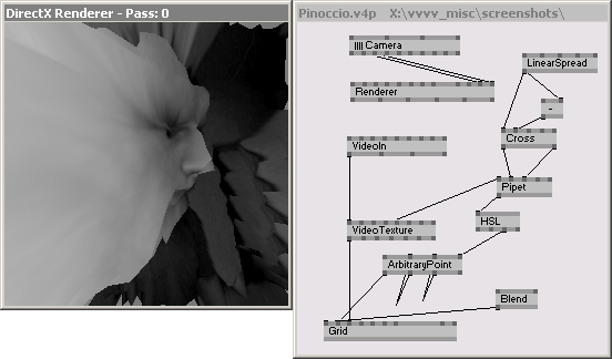

vvvv is a toolkit for real time video synthesis. It is designed to facilitate the handling of large media environments with physical interfaces, real-time motion graphics, audio and video that can interact with many users simultaneously.
vvvv uses a visual programming interface. Therefore it provides a graphical programming language for easy prototyping and development.
vvvv is real time. where many other languages have distinct modes for building and running programs, vvvv only has one mode - runtime.
vvvv is free for non-commercial use. Commercial use requires a license. Get the latest version from the Download section.
vvvv is being developed by the vvvv group.
vvvv it is suitable for many tasks involving common computer related media like audio, video, 3d animation, the internet,.. to name only the hottest. Besides creating and transforming content for the aforementioned media, vvvv is also well trained in receiving input from and generating output to various external devices.
Below the main features of vvvv are listed and briefly introduced. For details, please refer to the Documentation.
There are applications where one will need to use several PCs to achieve the desired output/screen count. In those situations it could become quite messy to deal with all the PCs individually. Instead, vvvv is suitable to control any amount of client computers from a single server with a technique called “Boygrouping�?.
Boygrouping lightens the effort involved in creating multi-screen systems or seamless multi-projection setups. It allows to set up a render cluster, where one can individually select which nodes will run on the server and which nodes will run on the clients. The ability to control which data needs to pass the network and which data is better individually computed on all the clients allows to manually optimize a setup. No magic involved.
Looks like it could be fun if you were into video (as in content creation)/3D exhibition/display/presentation as a hobby or as research or something... But, to me, to be perfectly honest, for home theater, it looks like a complete cluster-f*ck. It looks like a development environment. It looks like the epitome of the LAST thing in the world I want in my theater when I just want to chill and go watch a movie.
Looks like fun. NOT.
