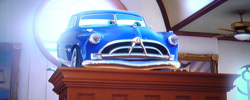

OK, the master plan at this point is to rob the complete red tube assembly (magnetics and all) from the doner as it's been tweaked out to the max. I hate to do this but I already had to borrow the green from it when the green imploded on the main (house) unit. All I have to do to it is install a red c-element and it's good to go. I really hated to take any parts off of this as it was set up perfectly. This is a image taken from the doner PJ on a 100 inch screen.

That shot in the previous post is one of my first round of screen shots. It's one of the best ones I've taken but still not able to match what you would have seen in person. We all know it's from a AmPro 4600HD but can you guess the source equipment?
