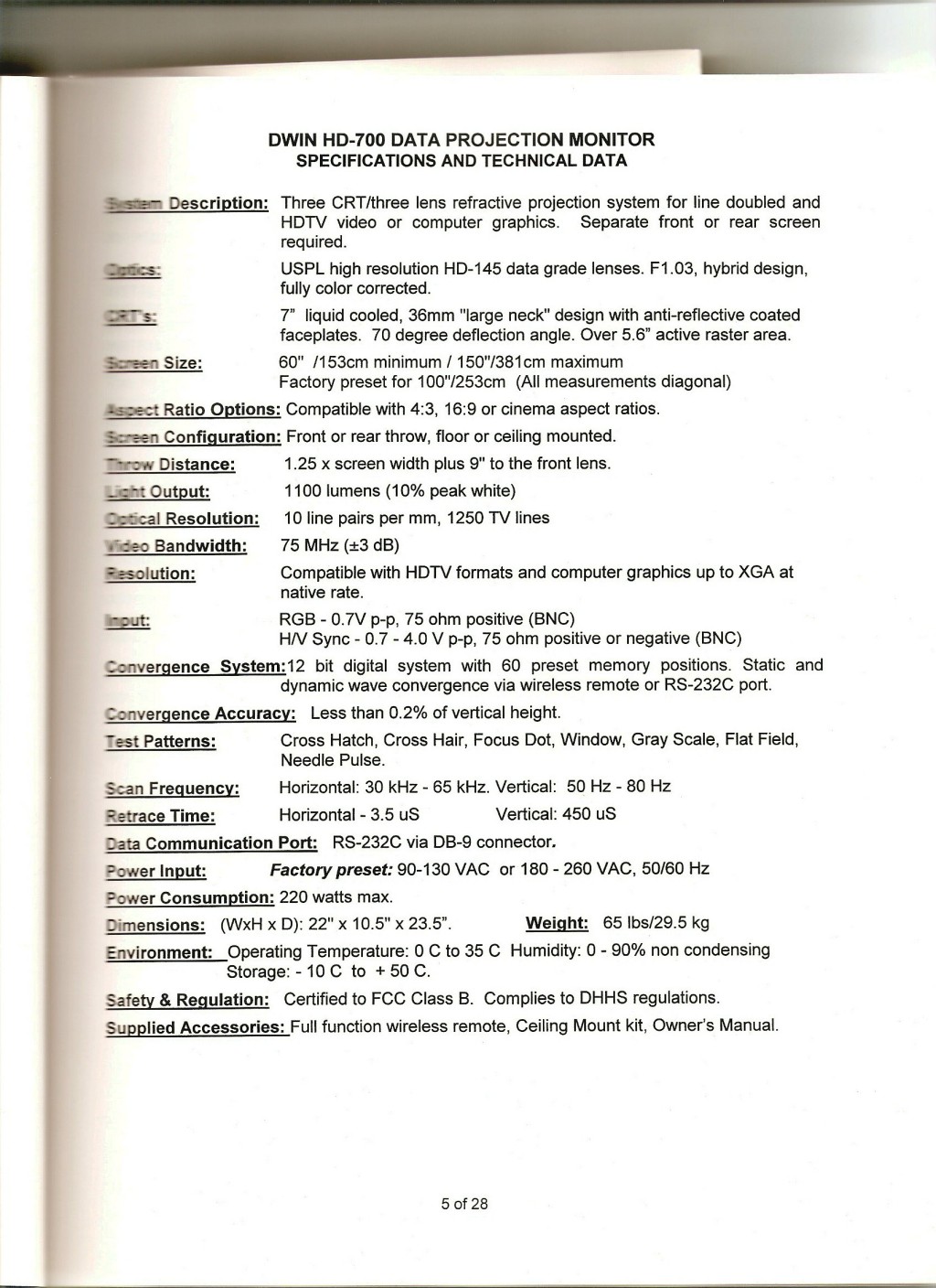

Jorge tells me he is a former Dwin dealer from way back. Also in his Dwin manual is says his Dwin 700 can accept a POSITIVE sync signal ( see pic below of the page in the manual ) while a normal Dwin 700 can only accept negative sync.
I'm at a loss on this one. Both converters not producing a usable signal at the same time.

Using my Sencore/Quantum Data 802b generator, I've had trouble especially with 720p synching on all 700s...I know forcing it to reverse sync always works...I would trust reality over Edward's documentation every time. Love the guy, but dare I say things could be lost in translation. I can almost hear him now, 'eh, positive or negative, as long as one works, meh'; just before taking a drag on his ever-present filter-free cigarette. He could never suffer the time I spent tweaking his invention, and never wanted to see mine fully tweaked in the studio.
I remember also having to occasionally use the digital sync option instead of analog on the generator, but need to check it that button doesn't also toggle from tri-level to bi-level sync also...I cannot remember at three twenty in the morn. That might explain the black level issues better than a mere 7.5 percent voltage difference not gaining in the entire range of the control.

Nothing within the Dwin I can find to fix the synch issues...rather 'fix' or alter the source itself, and if it cannot be switched in the unit (even with a firmware toggle) I don't see any reason why the synch leads cannot simply be reversed-wired. I would setup a test jig to quickly switch it, wouldn't be too hard to do...doesn't have to be pretty unless you plan on leaving it IN the circuit, then we're into another discussion.
