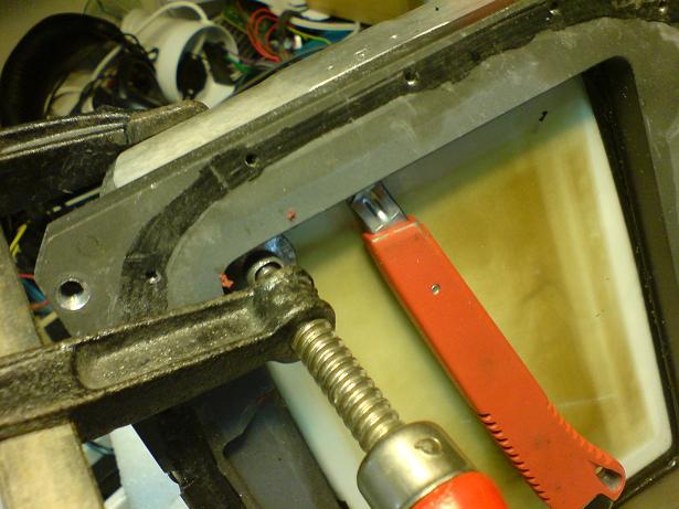

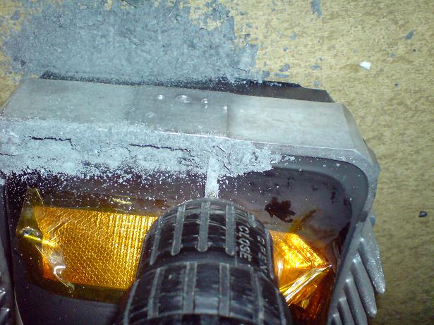

This is how i removed those tubes from hardware.
1. drillet out that "grey stuff"
2. soaked silicone few days with brake cleaning spray
3. cuttet silicone seam away with small blade knife

It depend about Barco, all hardwares I have removed (B500, B800, B808, B1200) had room for Olfa cutter and nothing else wasn't needed.
Marquee LC tubes I cutted as much I could and then pressed tube out with 20 ton hydraulic press. Very Happy
I used thick mdf plate against face plate, so that pressure is even in larger area.

At 9"Marquee tube, there were no room for blade.. Until that silicone was soaked while (turpentine or brake cleaner) Then with little pressure i was able cut tube out from hardware.

Pardon me for saying it, but you guys are a bunch of monkeys!
Let me explain a better way to remove a 9500LC tube from the LC assembly without harming anything.
You need a long drill bit that is small enough to easily sink into the space between the aluminum casting and the glass CRT,
touching only the silicone.
Put this long bit in a variable speed cordless screw gun and start drilling through the silicone, as many holes as you can, almost touching
each other. Be patient, it takes a while. Drill down until you encounter more resistance but not a bit past that point.
After you've completed your ring of nearly touching holes, insert a screwdriver or hex wrench that matches well to the size of the holes
you drilled, and start gently levering out the pieces of silicone between the holes.
Next, the removal: If you haven't already done so by now, disassemble the LC assembly until you have just the rear casting with the
tube in it. All the rest should be set aside.
Cut a piece of plywood or MDF or particle board or whatever else you have lying around, shaped to fit pretty neatly into the front of
the casting and touching the CRT face. You don't want a lot of gap between the edge of the block and the casting, because you want
to support as much of the CRT face as is possible.
This piece of wood you just cut should be thick enough that when you place it on the CRT face, at least a good quarter inch, or more,
is above the level of the casting.
Place the block on your workbench. Place the CRT and casting on top of the block, settling the block onto the CRT face. Now, get
out the clamps. Bar clamps are fine. Clamp both sides of the assembly to the bench with two or more different clamps. Tighten
them down to firm but not really tight. Every few minutes, give each clamp handle about a half turn, alternating from one to the other.
In a few turns and a few minutes, the silicone will give up and the tube will start to come out, UNDAMAGED.
I've done this a number of times and it's always successful. No problem at all.
