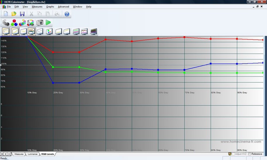

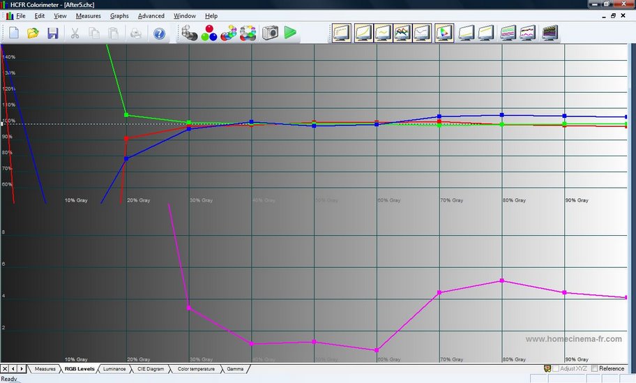

I use the spyder 2 and I have a bg808 with HD145 color corrected lenses and at default 6500k settings the red was at 140%. I was able to back that down, following the excellent tutorial that Kal posted and it looks way better. I'll try to attach the graphs.
After HCFR and spyder2
 Filesize:  73.56 KB
 Viewed:  3267 Time(s)
Default 6500k settings
 Filesize:  71.4 KB
