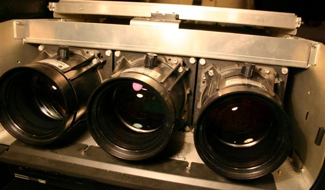

The stock HD-215 lenses on the Zenith 1200 do not have an outer focus ring like most lenses found on CRT projectors. There is only one focus ring. You will not therefore get as good focus in the corners with a Zenith 1200 as you do with some other similarly spec'ed machines like NEC XG or the Sony G70.
Here's a pic - notice only one focus ring per lens:
Does it make a difference however? Spend your day watching a windows desktop? Then yes, I can see the difference. But if I was doing that all day I'd get a digital in a heartbeat.
On Blu-ray movies? Nope, I really can't tell the difference and I'm a fussy bugger. It has a lot to do with the fact that (a) when you watch a movie you're more focused on the center of the screen and (b) when a director and his/her DP shoot a movie they're also more concerned with focus in the center of the screen (or on the subject matter).
I've thought about swapping them out but frankly, you'll never notice the difference with real life movie content. By all means swap'em out if you want something that measures better on paper.

I have to agree I don't even notice the edge focus is out a hair compared to the center. Now if I could pick up a set of lenses for cheap to try then I'd give it a go.
