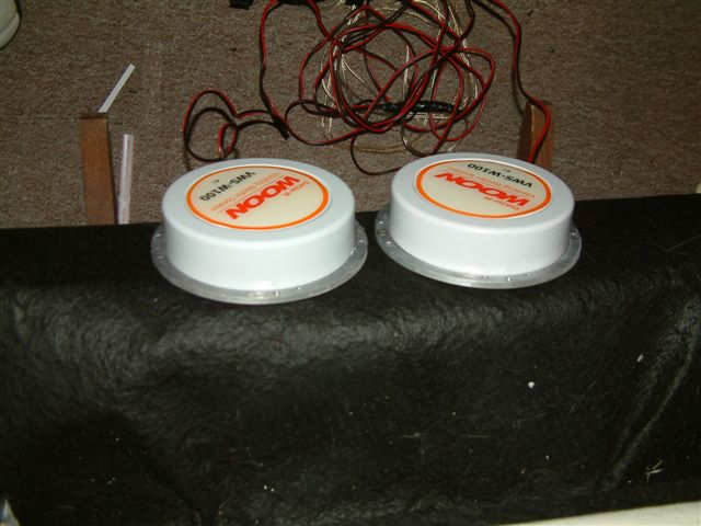

I bought 8 with 2 amps and put them pn the couches in the family room. I thought they were great but my wife didn't care for them. She said "It must be a guy thing." Anyway,I sold all but 2 and 1 amp and put them on the recliner in my office. I think they rock. The kids like to listen to music in "Daddy's cool chair".
 Filesize:  59.18 KB
 Viewed:  14349 Time(s)
 Filesize:  38.8 KB

I'm really dumb on audio stuff...What kind of amp do you use with the Auras? Do you need a separate amp for each transducer?
Mike
Posted: Fri Mar 27, 2009 2:44 pm    Post subject:
You don't need a power amp, under 50 watts per transducer is plenty. What I found in the car though is that the transducers really made the amp run hot and cut out, so I put two in series, and that worked fine. I'd do the same at home, and use an older vintage amp, one without the output chips, one that uses actual transistors in the output stage. I've had output chips smoke with strange loads.
Thanks Curt, that was exactly what I wanted to know. Especially about connecting them up in series. I think I might have an old Kenwood amp that has output transistors that would do the trick. Do you just install "Y" connectors and split the low level signal going to the existing sub?
Somewhere I read if you install 2 on the seat risers it can have a nice effect, is that true?

As for installation, trial and error. I butchered mine due to the weird curve of the bottom of the seats. To get them to fit, I had to break all the heat sink fins off the transducers and used speaker T Bar support rails from my pro installation stuff to mount them.
From what I heard from Aura back a bunch of years ago, the more mass that the transducers bolt to, the better. In other words, solid mass between your butt and the transducer will work better than a lightweight wood frame that they could be bolted to. It also depends on how much bass/shaking you want. Buy a pair or two from Parts Express and play with it.
