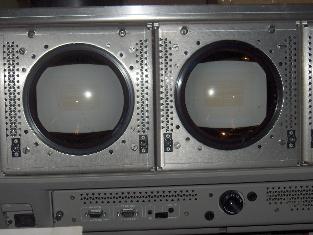

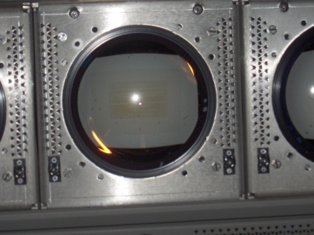

Guys, take a look at the below pix. These are from a Barco 1209s installed locally. I looked at the set, and saw that all three tubes (red tube is minimal) have text wear from a satellite error message that was left on the screen.
Can you give me a guesstimate as to how long you figure the static image was left on for assuming normal contrast and brightness?
Total projector run time is 12,800. There is a very slight 4:3 wear pattern from the installation (projector was sold new apparently a few years ago) showing normal wear, it's the satellite image burn that I'm concerned about.
I took the below pix with flash, but they are accurate of what I see just looking at the tubes.
Thanks!
Green tube
 Filesize:  87.27 KB
 Viewed:  7409 Time(s)
Blue and green tubes
 Filesize:  113.39 KB

What the deal is is that there's apparently a conflict between the various people that have used this projector. Owners are rarely at the house, other people use it. Owner is astounded that there are 12,800 hours on it, and 'someone' left on the set on this satellite error screen.
I figured with the say 6 out of 10' wear on the green, and the blue being about a 7, that this would take well into the 100s of hours, if not 2-3000 hours. Maybe I'm high on that count, but I certainly don't think you'd wear a tube down to a 6 or 7 over a couple or a few days, assuming contrast was at about 60 or so, typical running range for a Barco 9" set. I figured that somehow the set was left running, satellite went down, set was on 24/7 for a few months, and this is the end result. Everyone involved claims that my scenario is impossible.
So I told the owners and tech involved that I'd put up a neutral thread here without any bias. I was called in last, and have had nothing to do with this set until about 2 weeks ago when it was brought to the shop to be checked out.

Curt's absolutely right: Unless contrast is set into blooming (over 80 or 90 on that Barco likely) you're not going to get that sort of burn-in in only a few days.
A properly set up/calibrated projector can display a static image for many weeks with zero burn-in. Burn-in or wear is cumulative. A hour a day for 10 days is the same as 10 hours straight. I've spend a few hundreds over the course of year playing a certain game were the same status items were displayed on then screen. Zero wear.
I put 5-6 thousand hours on my last projector all of which had the same image width so you think you'd have some wear showing the sides of the screen on the tubes. Nope. Zero wear.
Same with my current projector: ~3000 hours or so doing constant image width meaning that at all times there's something displayed across the screen width so you'd think there was something worn in just a bit on the edges of the tubes. Nope. As I expected, zero wear/burn in.
I'm not stingy with contrast either. Getting 12 ft/L on my 8' wide screen.
