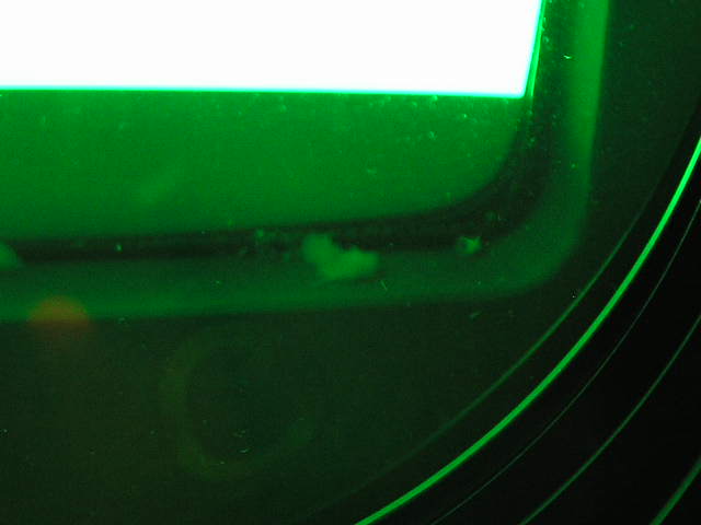

ACON is neat to watch. Very Happy I did a quick setup and watched part of a dvd just to make sure the set survived the trip okay. This is an obviously good upgrade over the toasted 1272 even without the careful setup I'll be doing later. However, I'm seeing a couple of issues and would appreciate any feedback...

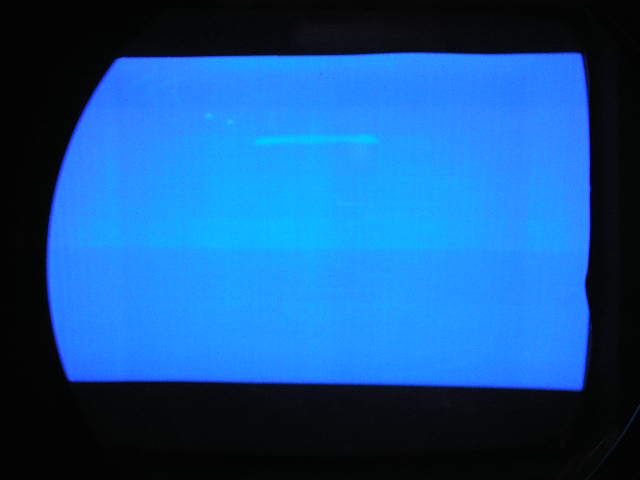

Comments on the following two pics would be much appreciated. I'm assuming the blue line is a scorch? New tube time?
What's the junk in the lens chamber? Is that something I can remove without messing with glycol?

you'll have to remove the bellow to clean the gunk out. Almost impossible to suck it out through the fill holes.
The blue line is probably banding, you'll have to show a screen shot to tell better.

typical old Marquee LC gunk,Almost every old LC Marquee has them. I would replace all 3 bellows and any tubes as needed. Also, depending on hours various board work for reliability. P14 first though, don't take chances on that one. Looks like you got a project on your hands but a working machine is a good starting point.
