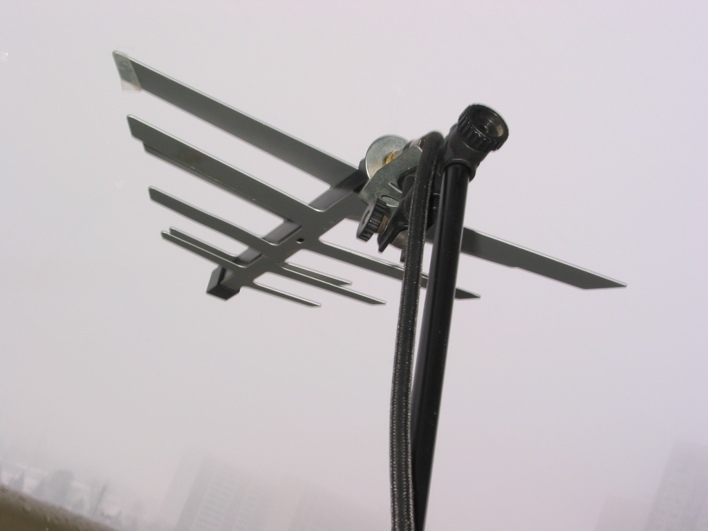

SO antenna's are hit and miss. My best antenna I have is an ATi knock off of the silver sensor ( which BTW is what's inside the PHDTV3! ) the ATi has no amp, I have it mounted on a lamp stand and it is yet to be dethroned as my best NON-amplified antenna.
Here's a picture of it:

Where can you find the above antenna and how big is it ?
My sister could use one as she is in a fringe area using rabbit ears...
Posted: Fri Mar 13, 2009 5:25 am    Post subject:
I'll go measure it. BRB Wink
16" long, 13" wide at the rear elements.
I'm about 60 miles line of site to the Buffalo stations ( Grand Island NY ) as the crow flies.
I'm about 10 miles from the Canadian stations (CN Tower ) as the crow flies.
I have the antenna 60 feet up off the ground and the nearest building in my way is about 3/4's of a mile.
Terk also makes a version of this antenna though theirs is a little phancier with 2 VHF arials too.
http://www.amazon.com/Terk-Technology-HDTVi-Indoor-Antenna/dp/B0001FV36E
here's a link to a discussion about it Wink
http://www.digitalhome.ca/forum/showthread.php?t=40741&page=3
Oh yeah, I mounted it on that lamp stand it's not included when you but your antenna. It came with a table top stand that tended to tip over.

Looks like a little YAGI type antenna. Do you have to swivel it around to hit different transmitters? Great info thanks! I take it from your response you would agree that a good antenna is cheaper than a fancy new tuner, eh?

I'm lucky actually. Grand Island is in line with the CN tower so I don't have to get off my azz and adjust anything.

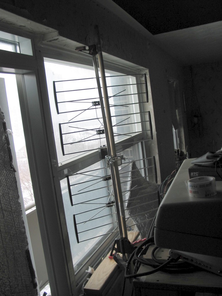

Yep I've seen those. I have the 4 bay type. I have it mounted in the window inside. It only got 65% signal as compared to the Silver Sensor outside. Then I opened the inner window so there was only 1 payne of glass in the way and the signal jumped to 98%! What a different a payne of glass made.
Only the bottom two elements are going through 1 payne of glass, the top two are still going through 2 paynes. The split in the windows you see there has the top part fixed ( 2 paynes ) and the bottom part slides ( 1 Payne )

Yep, outdoors is the only way to go to get a rock solid signal. BTW, Analog....that setup does not have a high of WAF. Smile
