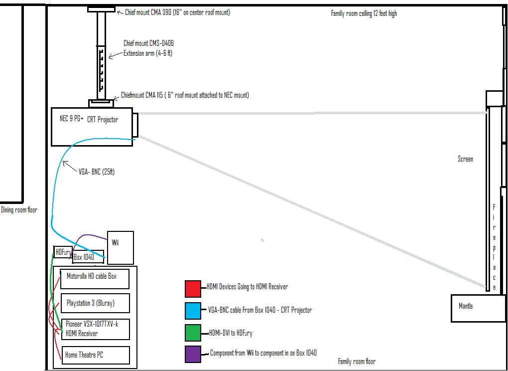

Here's my setup and even that isn't quite how it is now (at least you can see what I have going). I don't have the HTPC or Wii hooked up right now. I also run the HDMI out from the PS3 to the projector and not through the receiver.
Basically, it goes:
PS3> HDMI/DVI cable> HDFury> box1040> 25 Ft Python VGA/BNC cable> projector
sound is optical to receiver from PS3
it does 1080i beautifully. With a really white background you can see scanlines at 3 feet away. You'll be sitting much further back so no big deal.
You only really need a DVD player or Ps3, vga-bnc cable, the HDFury (gives you an HDMI input) and a receiver to make it work.
If you want to do it on the cheap, just to get it hooked up and running to see what it's all about, get a 25 foot vga-bnc cable and run it from the VGA output of your video card.

Get an HDfury. Run HDMI-DVI to the Fury, then plug the VGA-BNC cable into the other end of the fury and run it to the projector. That's how I ran my high def cable box for a year and it worked well. Hopefully you have an optical out you can run to a receiver for sound.
