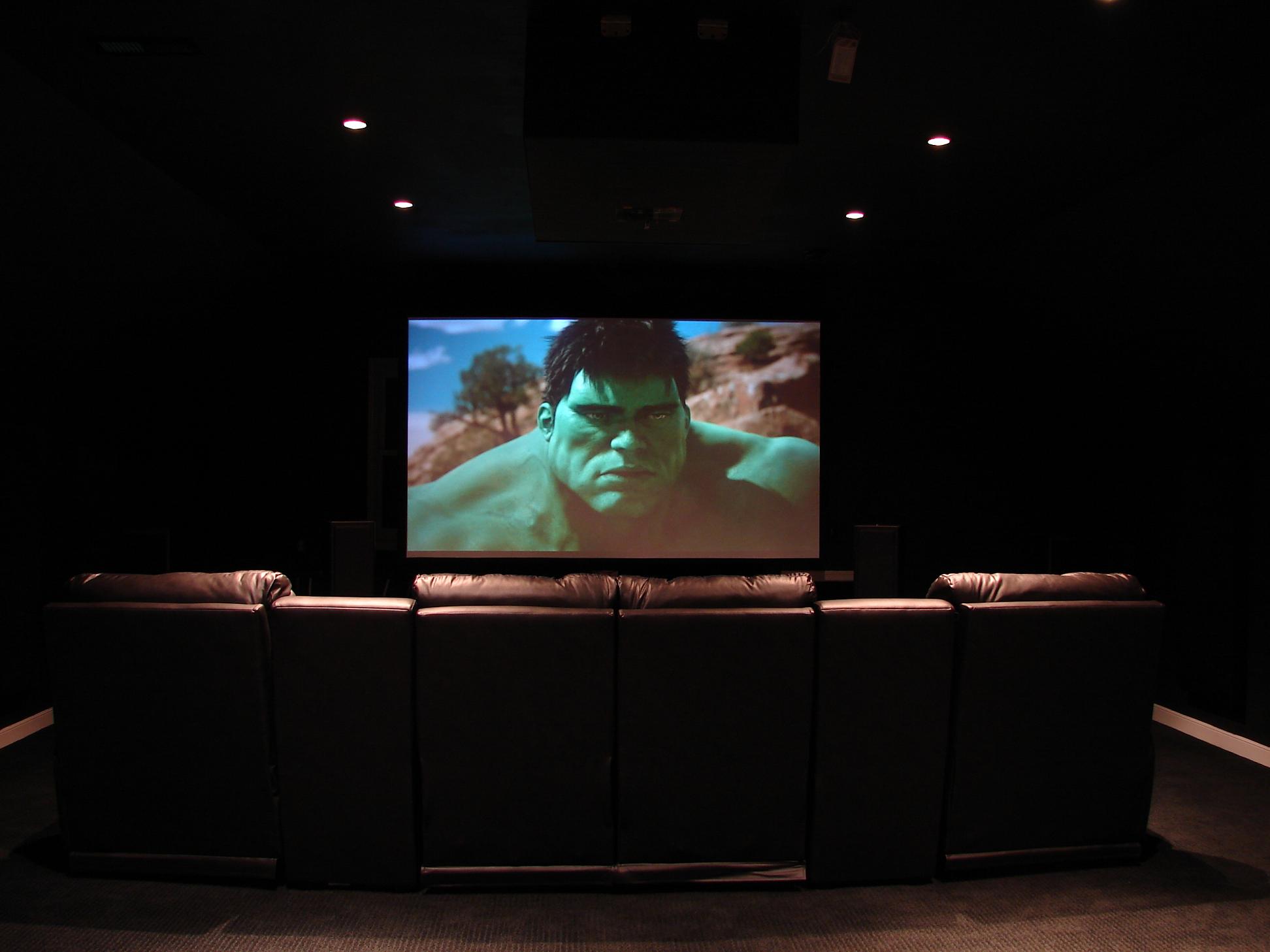

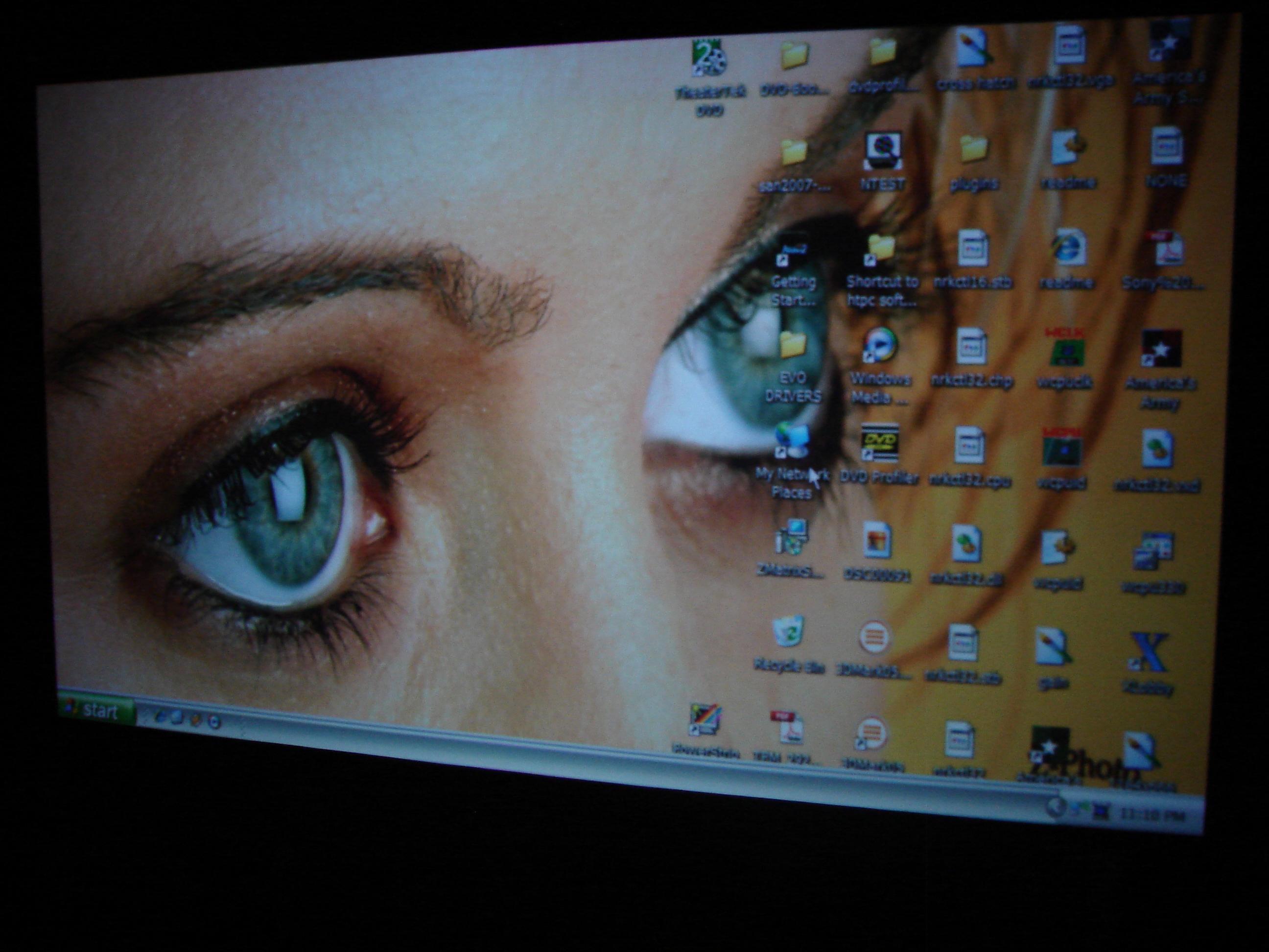

Posted: Tue Feb 10, 2009 12:20 pm    Post subject:
im no photographer but heres a few older pics. you'll recognize one of those desktops. my screen is 108" blackout cloth...
