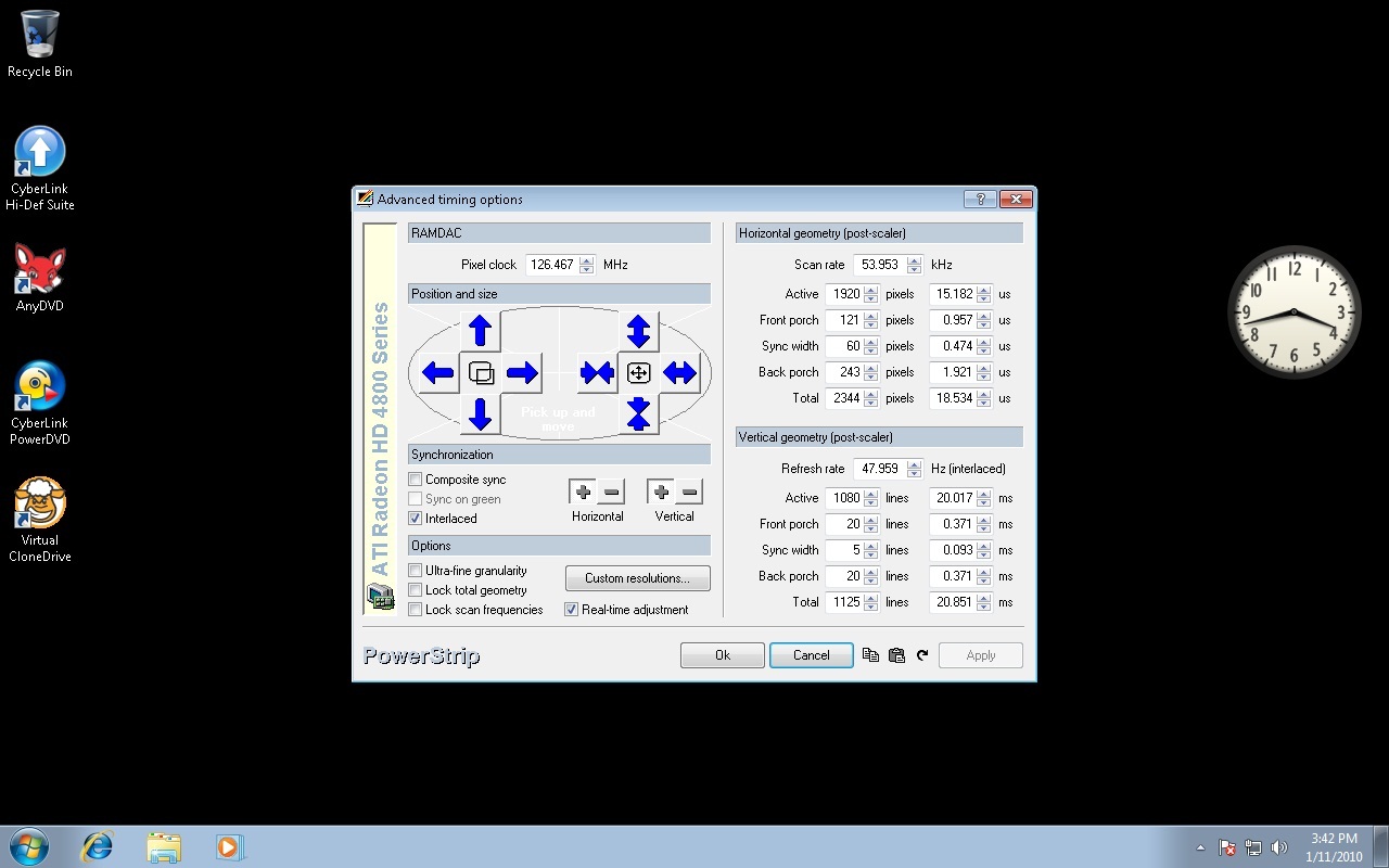

Perisoft, did you ever get this figured out? I had originally setup my bg808s with 1080p @ 72hz, but when I slide it around in powerstrip the refresh gets adjusted too. What I end up with motion judder with BR's.
I wanted to try 1080i @ 96hz and ended up with only the top half of the htpc image on the screen. I think this is the same thing you mentioned above.

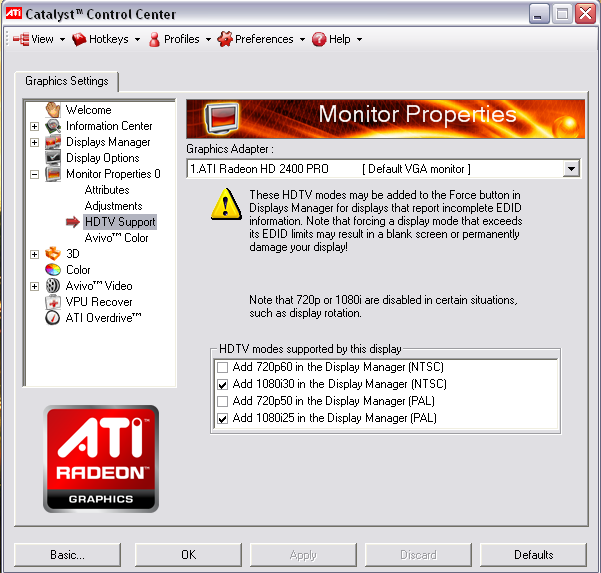

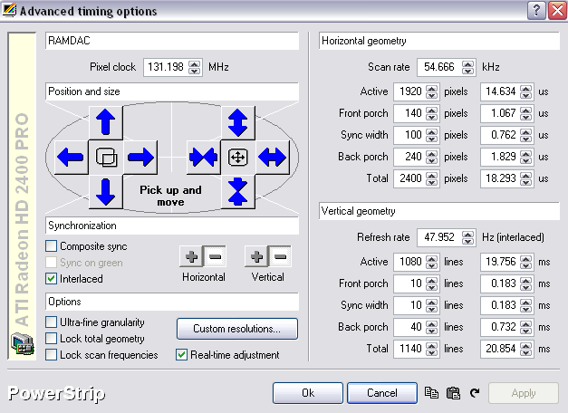

Enabling interlaced resolutions from Catalyst and selecting 1080i30 worked for me.
Then you can create 1080i96 resolution in Powerstrip. Vertical refresh should be 47.952 Hz.
Now you can turn deinterlace off from your player software, that could make playback smoother. Least it seem to help in my pc.

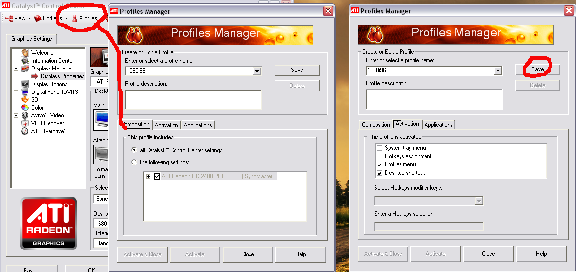

If you like to make desktop shortcuts for powerstrip resolutions, those can be made using Catalyst profiles, check my last attachment.

You have to put the card in "interlaced" mode by selecting 1080i 30hz (or 1920x1080 with a refresh rate of 30i or 29i) FIRST, using CCC or Windows display settings.
Then use Powerstrip to load the custom timing.
This is my timing:
PowerStrip timing parameters:
1920x1080=1920,112,128,115,1080,46,7,30,126874,542
Generic timing details for 1920x1080:
HFP=112 HSW=128 HBP=115 kHz=56 VFP=46 VSW=7 VBP=30 Hz=48
VESA detailed timing:
PClk=126.87 H.Active=1920 H.Blank=355 H.Offset=96 HSW=128 V.Active=1080 V.Blank=83 V.Offset=46 VSW=7
Linux modeline parameters:
"1920x1080" 126.874 1920 2032 2160 2275 1080 1126 1133 1163 interlace -hsync -vsync
Which is very slightly different to Kai's original, and maybe a tiny bit different to the one in the image above.

If BG808s show raster ringing in left edge with Marks timings, try those I posted. That's why porches are about 150 pixel wider.

Posted: Tue Jan 12, 2010 1:33 am    Post subject:
Ile, those settings worked great, thanks. I even made a shortcut on the desktop too! now I just need to make a another res for hdtv.
