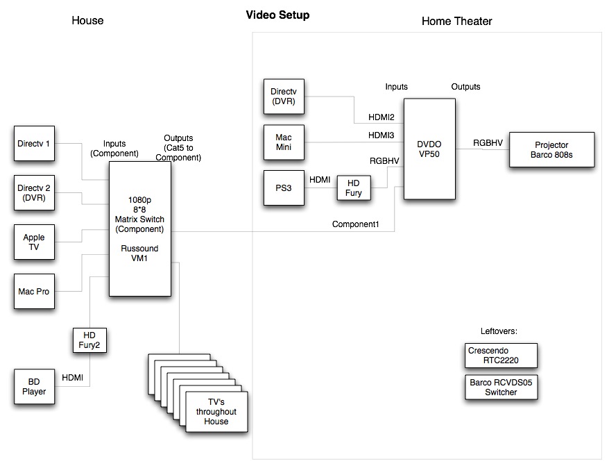

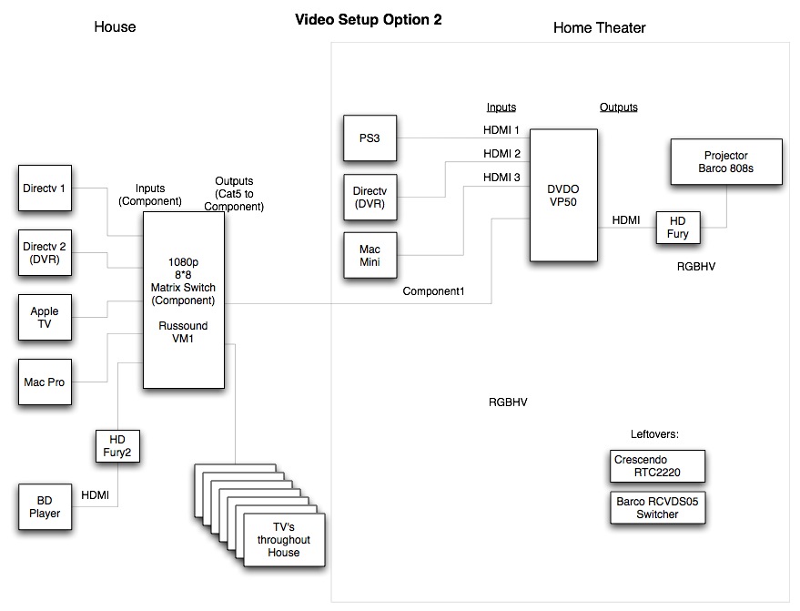

Posted: Sun Feb 15, 2009 7:18 pm    Post subject: No replies! Here are 2 configuration. Which one do you like?
Never got a single reply so I thought I draw things up and let you pick your preference.
I just like to get the best picture quality out the setup and like your advice. Would you change things? or which setup do you prefer and why?
My questions are only for the Home Theater setup. The house setup is a nice feature because it adds a lot of sources via a single input Smile
Thanks so much for your help.
Wolfman
 Filesize:  75.25 KB
 Viewed:  1921 Time(s)
 Filesize:  72.61 KB
Posted: Sun Feb 15, 2009 7:57 pm    Post subject:
Either set up should work fine. i don't think it matters where the HD fury is but it might be better as you have it in Setup 1. I guess try both and look for any differences using the PS3 only as it needs the HD fury. the other sources might benifit more by not running them through the HD FURY also
