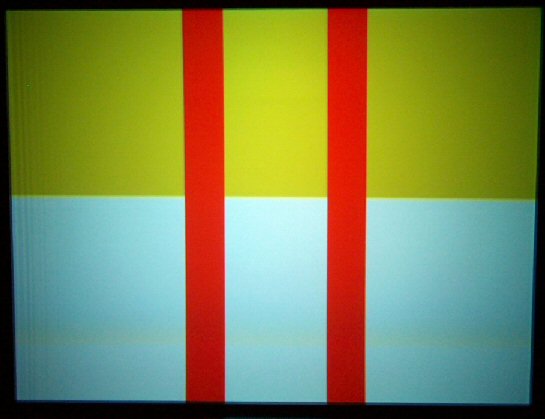

Are any Barco guru's aware of the apparent ringing/tearing on the left side of the raster (ceiling mounted) whilst the Horizontal Deflection board is in High can mode?....and if so is there a documented fix, for the ringing, rather than just swaping out Hor-Def boards to one which exibits the problem least worst.

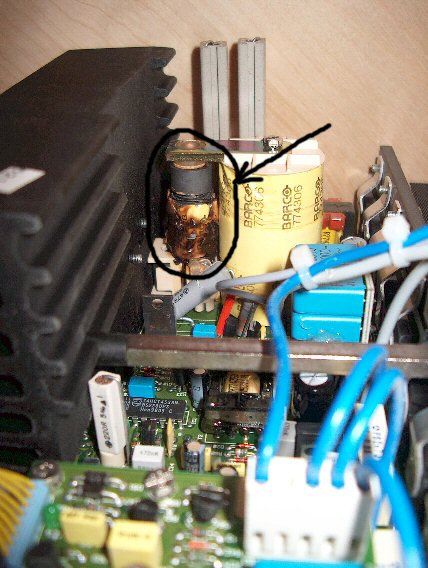

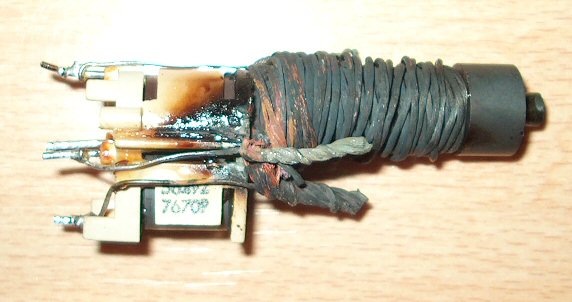

Bjorn had a similar problem and turned out to be a bad scan coil.

Look here: http://home.c2i.net/tomcat/1209.htm Smile
Posted: Thu Jan 15, 2009 3:40 am    Post subject:
So much for my memory..... Wink
That's the post I was referring to.

Posted: Thu Jan 15, 2009 5:58 am    Post subject:
Symptoms...
Thanks to Bjorn wherever he is ?
