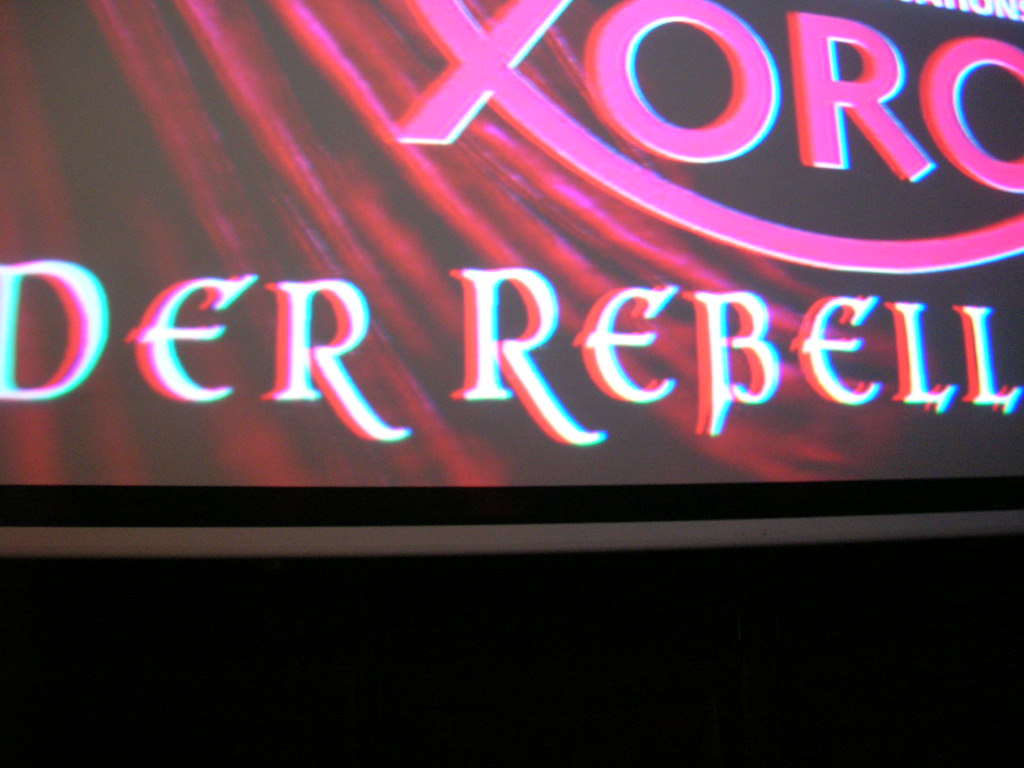

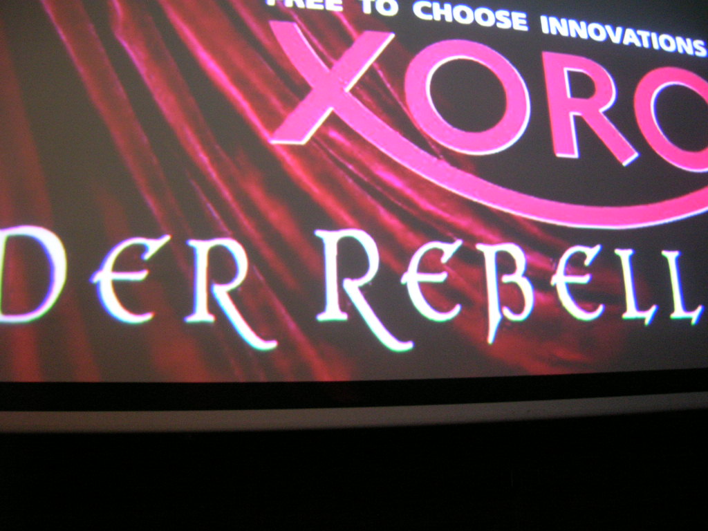

Sad My PJ is unusable: there are erratic horizontal movements between the red and green/blue picture. The problem started when trying to use a computer as a source for HDTV. It went away after reseating some boards and everything was fine using a DVD player and a line multiplyer (NEC IP 4000Q) as a source. Christmas I tried my luck again with the computer and the problem reappeared (and I cannot make it disappear again, also the DVD player signal shows the same defect).
I attach two sreenshots and hope someone knows what is wrong here.
Martin
looks terrible
looks fine

Posted: Tue Jan 13, 2009 9:04 pm    Post subject:
It jumps back and forth?
I would try reseating again.
If that doesn't help, I'd swap the Horizontal Deflection board, then the Oscillator board. (Curt?).

Posted: Tue Jan 13, 2009 10:10 pm    Post subject:
Surprise! I opened the beast, tried all the boards in the back without success and the toyed a bit with the connectors at the H DEF PWB - and at least for the moment the picture is stable.
I will watch for a while and see if it stayes that way.
Thanks for your help!!
