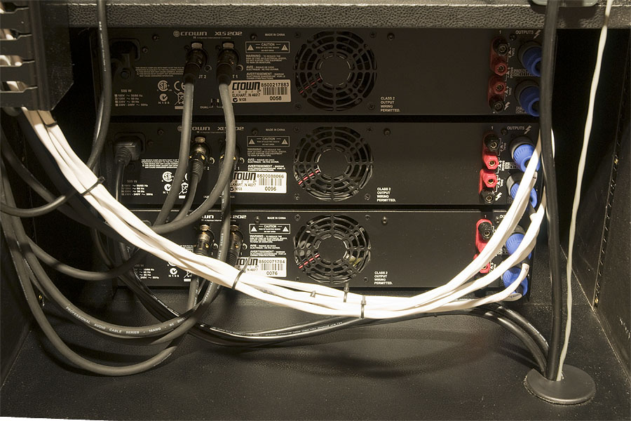

SC, what kind of Crown amps are you using? I actually paid the electrician to install outlets on a dedicated circuit to each speak location. I wanted to cover myself in case I went with per-channel amplification at the speaker location. That may prove to be overkill, or just expensive. Very Happy
Posted: Sat Jan 17, 2009 3:30 pm    Post subject:
~40' here for my three across the front.
Posted: Sat Jan 17, 2009 4:19 pm    Post subject:
Wow, you wired it for active speakers? Did you really do a dedicated circuit to EACH speaker location - i.e. each on its own breaker? Or, do you mean a dedicated circuit for all the speakers?
My Crowns are XLS-202D's. I thought about going to 402's, since it seems like a lot more guys use them... But, price jumps $100, so about $1200 for the three amps instead of $900. The 202's are already at 300wpc into my 4-ohm M&K's (I was upgrading from 120wpc AVR!). That gives me enough clean power to run to about 105dB - in the back row! I haven't even tested it from my listening location, but I know it's louder. The 402's are 450w into 4-ohms, and I just didn't need that for my room size or speakers. Larger room or bigger room, and the 402's would be great, though.
Posted: Sat Jan 17, 2009 5:24 pm    Post subject:
Nah, I wired one circuit specific for all speakers with outlets at each location. I thought to install amps up front, in back, and a couple of small amps for the surrounds. But this was only if resources were available otherwise I'd run cables for AVR amplification only.
