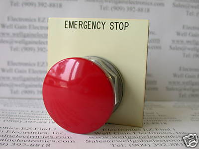

Never burned a tube on my Barco's but would this be a good safety switch to add for an emergency ?

Jus as long as you make it a big red one.

Nice easy to find button ! I like that ! Mr. Green Mr. Green Mr. Green

I stold that here:

What are you planning to use this for?
If its a manual switch, it might be that in most cases by the time you think you want to use the switch its too late. The Barco's have a lot of detection circuitry built-in to attempt to already catch the most basic, common failures that might cause a scan fail and burn a streak across your tube... ouch!
If you want something to kill it while your "pulling maintenance", you can pull the EHT board out....
-Mark

I wouldn't bother. I've never seen a Barco with spot burn. No wait.. I have... I was playing with a defective neck board the other day, 'fixed' it, and it spot burned my test set. Under normal circumstances I can't see it happening though.
