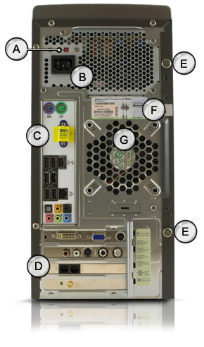

My PC:
NVIDIA GeForce 8500GT VGA DVI with 256 MB
AVerMedia M791 NTSC/ATSC TV Tuner Card
(Back panel illustration attached)

 Filesize:  86.46 KB
 Viewed:  9795 Time(s)
 Filesize:  86.46 KB
