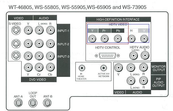

Posted: Wed Dec 24, 2008 7:02 pm    Post subject:
Sorry, I am actually working today. Smile Had to put out a couple of fires.
I just noticed I had to update my email address for this website. Adelphia cable ceased to be and Comcast bought them and forced everyone to change the email address domains.
"kartXXXman0@comXXXcast.net" Just remove the XXX's.
Posted: Wed Dec 24, 2008 7:55 pm    Post subject:
Ok, from the perspective of the Mits back panel the High-Definition input is the same regardless which model you have from that manual/sheet. I created a RED rectangle that high-lights the RCA-style connectors for using Component video. I also created a BLUE rectangle for the connectors for using RGBhv video. Both Component and RGBhv are analog video transports.
The HDTV Control input isn't DVI or HDMI, and I have to wonder if it is Firewire. Firewire is not a supported consumer video transport by the CEA (Commercial Electronics Association). The cheapest way to view both HD sources (Blu-ray replayer and HD DVR) is to use their Component Video outs.
Using Component video cables, connect the Sony Blu-ray player and DirecTV HD DVR to a Component Video Switch and use a third component video cable from the switch to the Y+Pr+Pb connectors highlighted by the RED rectangle.
Now, pickup the Mits menu, go into Setup, and then Input Assignments and look for an input (mine says DTV, but yours may be HD) and set it to YPrPb. When done, exit the setup and select the DTV ((or HD).
If you wish to go the digital route it will be more expensive, but I can guide you through the physical setup.
