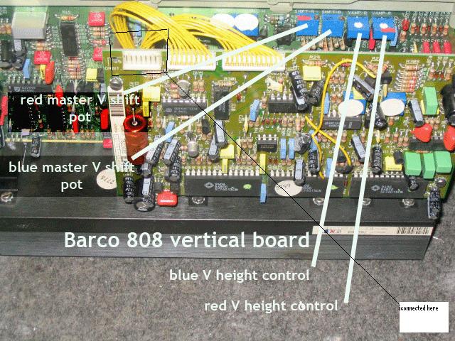

what I did was connect the board 3 yellow wires into a connector on the vertical board rather than on the video board. I don't get any picture at all.

this is where I accidently connected my board 3 too

Posted: Wed Dec 24, 2008 2:00 pm    Post subject:
You blew up the V board. I've done that here myself.
Let me know if you want to send it in.
Cheers!
