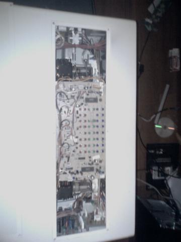

hey guys, I'm having a flickering image issue, and i need help calibrating this thing.... I messed with all of the calibration knobs and now i'm totally lost.... paid 30 bucks for it, would like to get it working again!
here is what it's doing for the flickering thing;
http://video.google.com/videoplay?docid=-1942441378077024878&hl=en
here is a pic of the calibration screws i turned and now its all funky; the PCB board says pioneer, maybe someone has a manual? i really want to use this for a garage theater!
ty

ok, i was messing with the screws and got it looking decent, but it isn't perfect yet.... and the flickering is still happening.
It did have a brief stint where the flickering totally stopped, and i thought it was fixed, but then the menu would not come on, when i restarted the crt the flickering started again and the menu was engaging again also, so i believe the flickering is being caused by the menu pcb somehow..... i wonder if there is a way to disengage the menu column.... is it safe to clean these pcb's with naphtha? i really want to get this thing working...!

As a general rule for ANY CRT projection set, you want to set electronic controls to their effective mid-position, then adjust those controls that have the largest impact first followed by finer controls... For example, start with green keystone, then match the R&B keystone to the green. Then linearity, bow, and other controls, finally ending with gross and fine ('zone' or 'point') convergence (if equipped.)
This way you'll be taxing the electronics the least, thereby generating less heat, improving stability, etc.

Ah, the intermittent turnoff is the key/ MOst likely the set has a bad focus block, that's covered in the Zenith FAQ/tips section on the main site. I've got a couple left, Zenith discontinued them a long time ago., If the tubes are in good shape it's worth doing, if not, then I wouldn't spend the money on the focus block.

So here is what happens with the flickering;
I turned it on and tried my best to calibrate it to the crosshairs.... did an OK job i think.... but i have to read that manual! (thanks).... then after about 1/2 hour of it sitting on the flickering stops, but the menu won't engage! as long as i leave it on it goes forever fine with no flickering! it is only when it first turned on, the menu re-enables itself and it's back to the flickering!
I think the cannons have some life left in e'm as once the flickering stops it is very bright , all three are working great.
