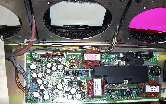

Posted: Mon Dec 01, 2008 7:08 pm    Post subject:
You should take lenses off and open top cover of powersupply (thats one is under lenses, big wide metal box) take cover off and you should see green leds for every voltage. If some of those doesent lit, then there is something wrog. Btw there seems be more seleco knowledge at -> http://www.avforums.com/forums/crt-projectors/
It has be long time when i serviced Seleco, so i dont remember much...
Edit: i found picture from seleco500 powersupply, on left hand there are those leds..
 Filesize:  100.88 KB
 Viewed:  9794 Time(s)

Posted: Sat Dec 06, 2008 3:22 pm    Post subject:
hi,
thanks for your replys already and yes, i am familiar with the internals of the projector and i do have electronic knowledge.
i already found the power supply and when i switch the main switch on, the +200V, -200V, and the +40V Leds light up and then dimm off again. the two red Leds at the back of the projector flash and the left one flashes once mor and then nothing happens.
I hope that someone can help me with he schematics of the projector or any ideas what the fault could be.
Thanks.
Firefix
