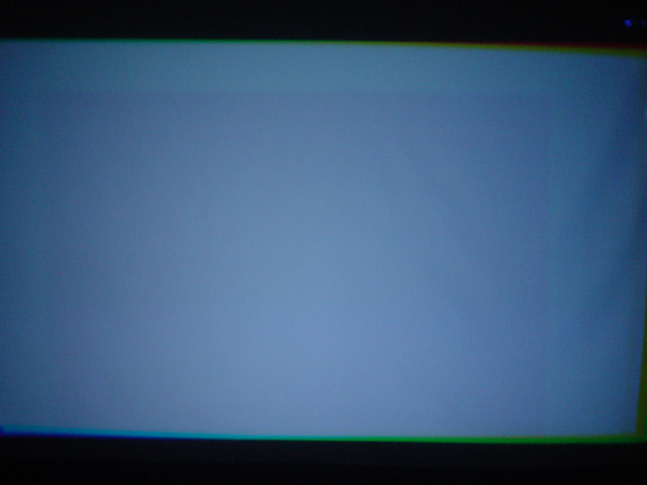

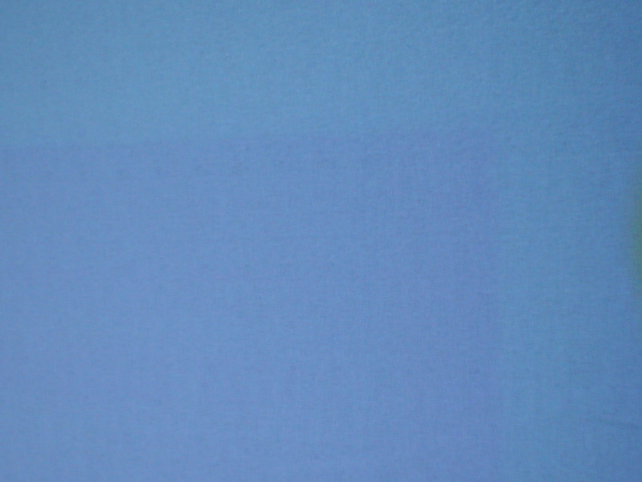

This is a picture of a 90 IRE raster. It is not precisely converged and it it being projected on a white
wall- but you get the idea. I think in you would notice it in normal use. The projected image is 110"
diagonal which is the size of my screen- so the burn in is pretty much to scale.

Person99
Posts: 4899
Location: Flower Mound, TX
Posted: Mon Dec 01, 2008 11:50 pm    Post subject:
Yep, it was set up incorrectly and way too small of an image area. That is why I said "unless the tube wear is way too small of a tube area" which in your case it is. You are in a pickle--depending upon how much you paid for the PJ. If you paid much less than $1000, then probably worth retubing. If you paid much more than that, then retubing may be the only option--but I wouldn't be happy about it. YMMV
