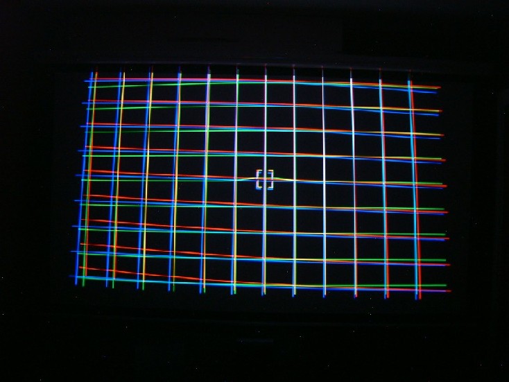

Being a newbie I have many questions, however, we are going thru working on refocus and adjustment tweeks. On the setup remote there is a button (PHASE) which I activated. An obtuse grid appeared much like a focus grid. The grids representing the colors were in areas perfectly in line (Phase) while much between them is not. Referring to the manuals I could not find any info. Can someone please explain and if these are to be in alignment (Phase), how do I do that?

Chuchuf on Phase wrote:
The idea with the phase adjustment is to get the hump in the middle of the vertical lines and not have any (or as little as possible) distortion on the horizontal lines as they aproach the edge of the screen. If you take and swing the controls you will see what I mean.
Terry
See attached image for a properly set up phase screen
Kai
good Phase setup

On an XG, just get the green hump and crosshair in the middle of the screen. Ignore the other colours.
