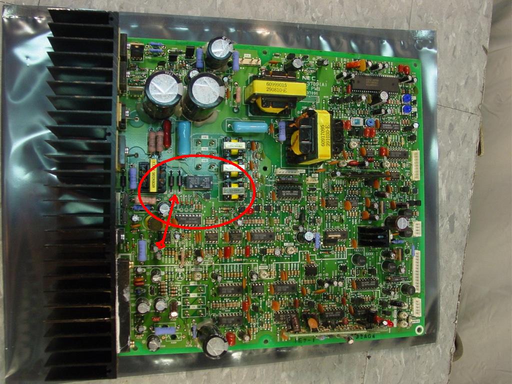

Posted: Mon Nov 24, 2008 8:49 pm    Post subject:
Here is a Board 3709 in the projector that has some oily dark substance on its in the area of the Circle.
is this the area what would control the the left and right static adjustment?
I cleaned it off with some 99% alcohol.

Posted: Mon Nov 24, 2008 11:41 pm    Post subject:
That is the deflection board. The C-drive is underneath between the tubes.
