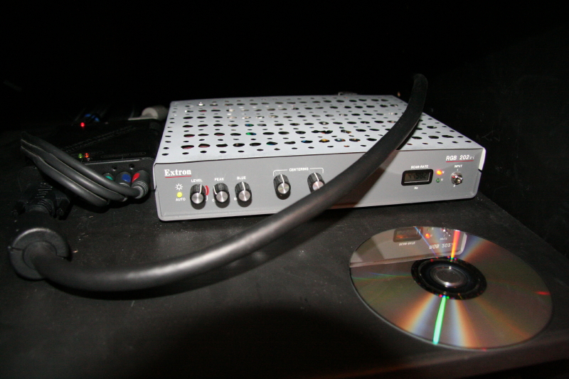

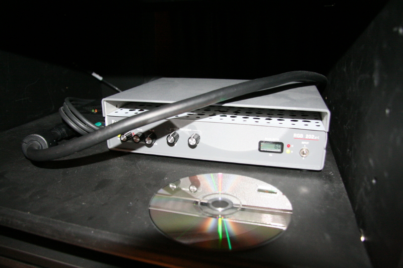

Here's my solution for "improved ventilation"!
I have two such boxes and I noticed (and read in several places) that they can and do run quite hot (heat can always promote failure). FWIW, I also noticed that one runs a bit hotter than the other (don't know why they have the same components inside as near as I can tell). So, I made a replacement cover to keep the units cool but the fingers out. I leave the original cover set over the top to keep dust out.
Just what I did. I also figured that keeping the heat down would keep the settings from drifting. So far (over a year or two) I haven't had any issues or failures. Wink

Good idea Picree. Where did you get the perforated metal you used?
picree
Joined: 31 Mar 2006
Posts: 351
Location: Johnson City, TN
Posted: Sat Nov 08, 2008 4:10 am    Post subject:
No secret. I'm unabashedly a cheapskate. Believe it or not I had the patience to drill holes in some old aluminum flashing (roofing) and then spray painted it gray to match. If you have a little cash to burn, another option is to get some of the expanded/perforated aluminum air-duct grill sheets they sell at Lowes/Home Depot (very pretty and about the same gauge). Trouble is you have to buy an entire 3 x 3 sheet (I think it might have been pricey which is why I didn't do that).
Be very careful to get it flat though. There are some HV components close to the top that only have a thin non-conductive covering. I wouldn't do this and then put it somewhere that kids might be poking their hands into. A thicker stock material would be better for rigidity and to avoid inadvertent contact with internals.
The 202xi (stock) has absolutely no air vents so it's no wonder it gets hot.

Posted: Sat Nov 08, 2008 6:10 am    Post subject:
Hey Picree why didn't you just drill holes in the stock case?
picree
Joined: 31 Mar 2006
Posts: 351
Posted: Sat Nov 08, 2008 2:36 pm    Post subject:
Way too thick for that many holes. Much easier to drill through the "tin can" material...plus if it didn't work out or I wanted to sell it I still had the original lid.
