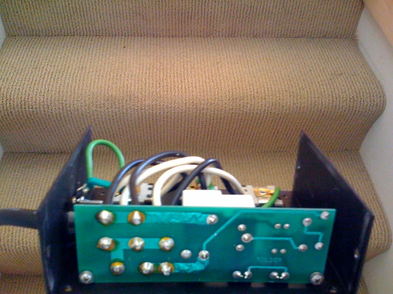

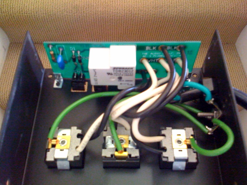

So, I was scrounging around in my stash downstairs, and remembered I had an old Niles AC3 I got with a big lot of equipment when I bought my HT recliners. That's cool, because the AC3 is about $125 new. The only drawback is it only has two switched outlets and one that's always hot. I need 3 switched outlets. I know I could use a strip or an outlet multiplier, but I'm trying to keep my rack clean here, right?
Well, I cracked the AC3 open, and it'll be really simple to mod it to switch all 3 outlets - I just wanted to see what you guys thought would be the best way.
I could drill a hole through the PC board next to the other two, but I'd have to remove the solder mask and there's no pad to speak of, so I'd be removing trace area. I don't like that idea.
The best way I thought of was making a "bus bar" out of a piece of 14-ga copper with the insulation only removed in strategic locations, and just soldering and capping the end of the bar to the (currently) unswitched outlet's hot lead.
Look OK to you guys?
Thanks,
You can see unswitched outlet on the left - the hot goes down and joins with the hot from the outlet on the way to the hot side of the relay.

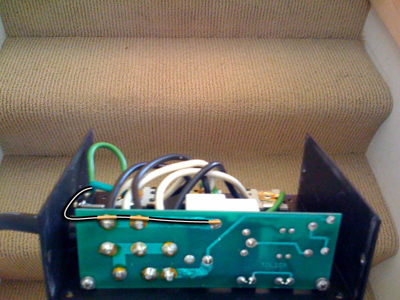

Here's my mod idea. Provides plenty of current-carrying capability and leaves the AC3 relatively easy to return to unmodded condition. Loose end would be longer and soldered and shrink-wrapped to the existing unswitched outlet's hot lead.

Posted: Wed Oct 29, 2008 11:43 pm    Post subject:
You don't just want to jumper to the unswitched outlet and disconect and cap the old unswitched wires? Seem's it woulb be easier.
Posted: Thu Oct 30, 2008 3:56 am    Post subject:
Hmm... I guess I figured if Niles ran each outlet pack to it's own pad on the board and didn't use jumpers, I shouldn't, either. I was concerned maybe the trace wasn't designed to handle the whole 15A the box is rated for, but then I guess my mod wouldn't change that, would it?
I also assumed I wouldn't want to mess around near the outlets themselves because of the nylon (wouldn't hold up to well to the heat from the iron, would it?
I guess I could just cut the hot to the unswitched outlet, cut the hot to the adjacent switched outlet, and solder them all together and screw a nut on, couldn't I? I suppose the 14 ga wire used on a single outlet is designed to handle a 15A load all on its own... so two amps on one hot isn't an issue, is it?
Duh.
Posted: Thu Oct 30, 2008 4:31 am    Post subject:
How much do the amps draw?
Posted: Thu Oct 30, 2008 5:01 am    Post subject:
500W x 3 amps or 1500w - or about 12.5A. Of course, that's peak, and these are audio amps we're talking about, so they'd only over draw that much for very brief durations... As in fractions of a second. Turn-on would probably be the heaviest instantaneous draw of all, but that's probably only for 1/100 of a second or something. Even during really loud scenes at close to reference volume, I bet each amp would probably be drawing half its rated power, or about 6-8 amps.
Posted: Thu Oct 30, 2008 5:10 am    Post subject:
There you go you should be fine. You know you're drawing too much power off the AC line when your TV screen gets smaller.
You have it all figured out already.
jask
Posts: 10187
Location: kamloops BC
Posted: Thu Oct 30, 2008 7:32 am    Post subject:
check the rating on the relay.
Posted: Thu Oct 30, 2008 11:13 am    Post subject:
I did - it's a big'un. Huge, actually. 30A/250v. So, no prob there for sure!
