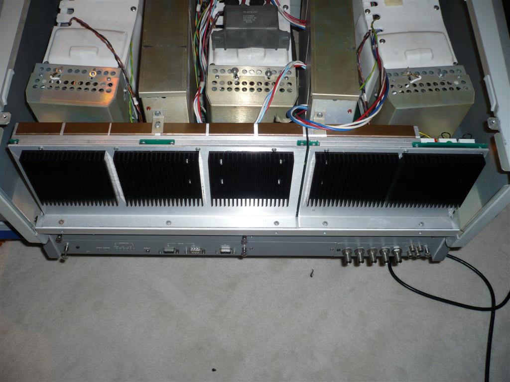

By the way, are the photos of the heat sink. So is this the "bad" Marquee 1993 8000 model?

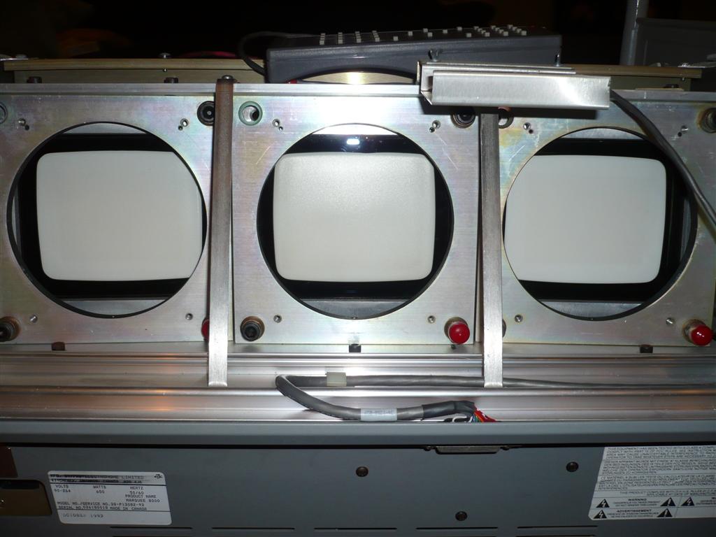

Also, here are some pics of the tubes. They are not mint after all, but the wear is super light. It's hard to see it from all angles.

Yepp you have the older model Sad sorry. i guess you should look for another Marquee or go for the G70's. the HDM,CLM and the whole back heat sink arent going to get you much. you might get some good money for the tubes they look very good. not sure about the LVPS on that model.
yeah thats' a Dinosaur for sure. Tubes are decent though and there's lots of Aluminum there to recycle too. LVPS, focus, and even HVPS can be saved and used to troubleshoot another marquee if needed.
