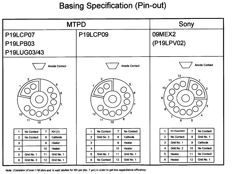

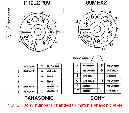

Are there any more of these Sony tubes left. I'd like to try and adapt one to a AmPro neck board. What was the actual pinout that finally worked for you?

Yes he has some used and some new, here is the pin out for the tube and TSE marked them in for a Marquee neck board. I think they will work fine, Aferg tested three, one of each color, on a Marquee modded VNB the way i did it in the 09MEX thread started by Voodoo. They worked good for him and he said using the stock marquee focus coils and magnetics it was nice and sharp, you can see in my pics it looked good also with no CPC magnets on it yet and none of the magentics full secured. it was just a quick test. I bet it can be done for any neck board that is PCB style sockets like the marquee VNB, if not i am sure someone with ingenuity can make them work. PM me if you want his e-mail address .
VNB Mod
Original pin out diagram

Pin out and orientation changed for panasonic tube layout
