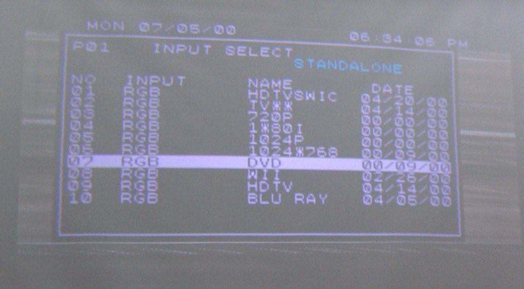

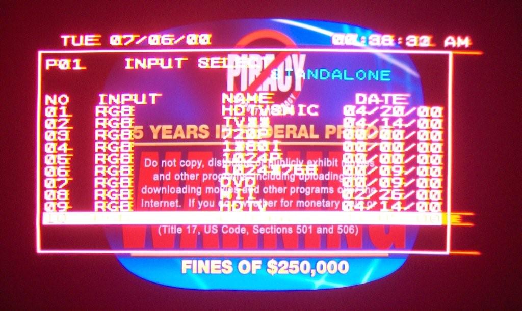

This strange bleeding of the red only affects menu's and not all of the time. Usually after the projector has been running for a while. What causes it and should I be worried? It's done this since day one.
Here are 2 pictures. The bleeding red menu and the normal menu (ignore the faded image as the picture is from daylight). Since it doesn't appear to affect anything else I hope it isn't serious.

Could be two things, looks like blooming of the red, cause too high a contrast but if its only on red then he G2 is too high for it. or it can be the focus for the red has gone bad.

Try turning contrast way down when you have the menu up. If the problem goes away at least you have somewhere to start, You'll know that the RED is getting to much contrast. Shouldn't be too hard to troubleshoot after that. It certianly looks like blooming.

Looks like blooming to me. Does your NEC have seperate contrast controls for the menu's like a Marquee?

I confirmed it is only affecting the menu's. The grid pattern is fine (un-bloomed). As I said it starts out normal, but after it warms up the menus start to bloom.

Bleeding can be caused by improper G2 voltage, a weak 10uF 160v volt capacitor on the Video out board, or a weak cathode.
Usually, if it only happens on peak white, either it's G2 or the tube's getting tired.

I paid attention today. It blooms after about 5 minutes of running time. I've tried decreasing the red Kelvin (B&W) way down and it didn't go away.
I put picture mute on when I had to step out for an hour and when I came back the menu was normal again... for about 5 minutes.
It's only the red tube and only with the on screen menus.
Any thoughts on what I can do to narrow it down for Curt when he gets back?

I am guessing that the red CRT socket is bad. I've seen that before. Try swapping out the red CRT socket with the green. All three are identical. If the problem switches to the green, then you know the socket is bad. I can fix that.
