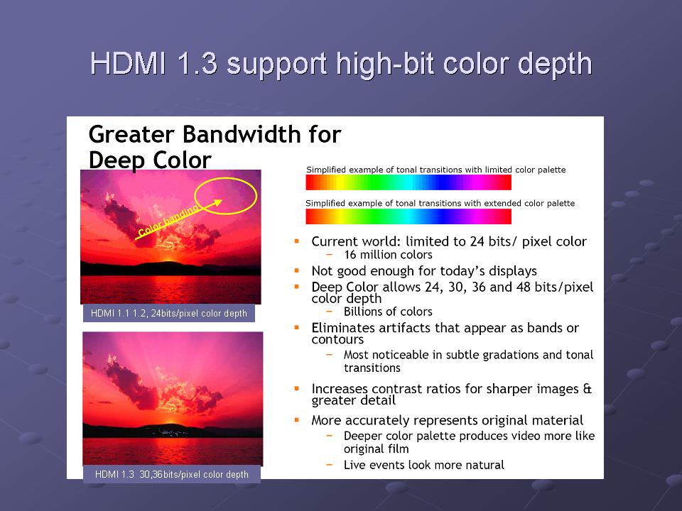

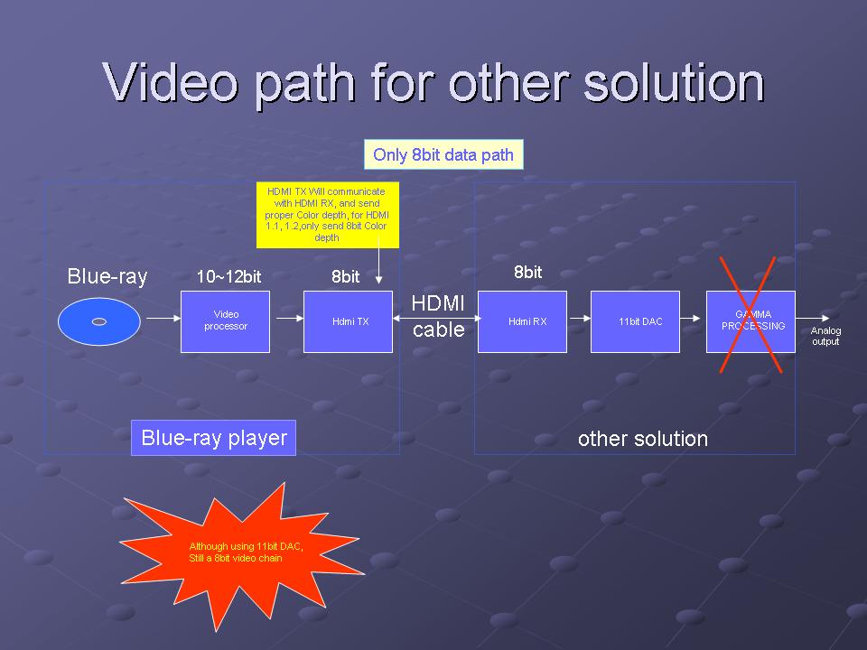

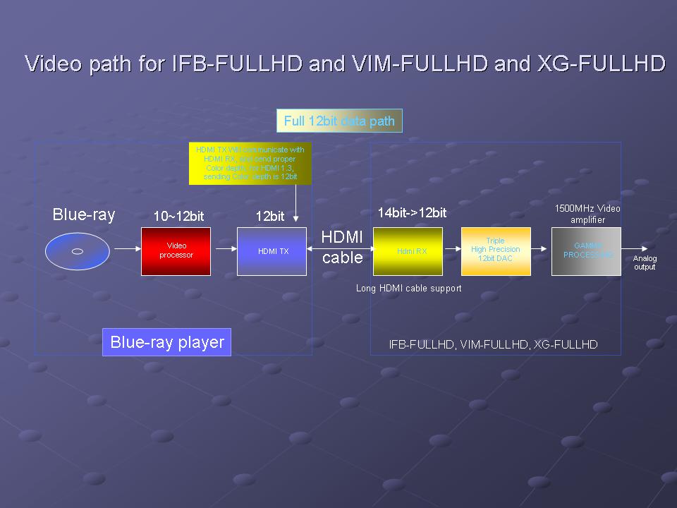

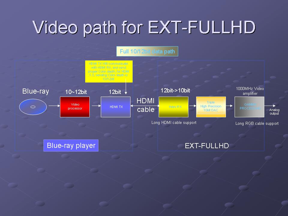

hi, here is the video path you can see, the EXT/IFB/VIM/XG-FULLHD is fully support 10/12bit deep color~
and other solution will be only 8bit path.
other old hdmi (V1.1 V1.2) solution data path

XG/IFB/VIM-FULLHD video data path

ext-fullhd data path

HDMI 1.3 source support deep color, but need HDMI RX support HDMI 1.3 also.

hi, the EXT-FULLHD and IFB-FULLHD are good picture quality, there is not big difference between them~
