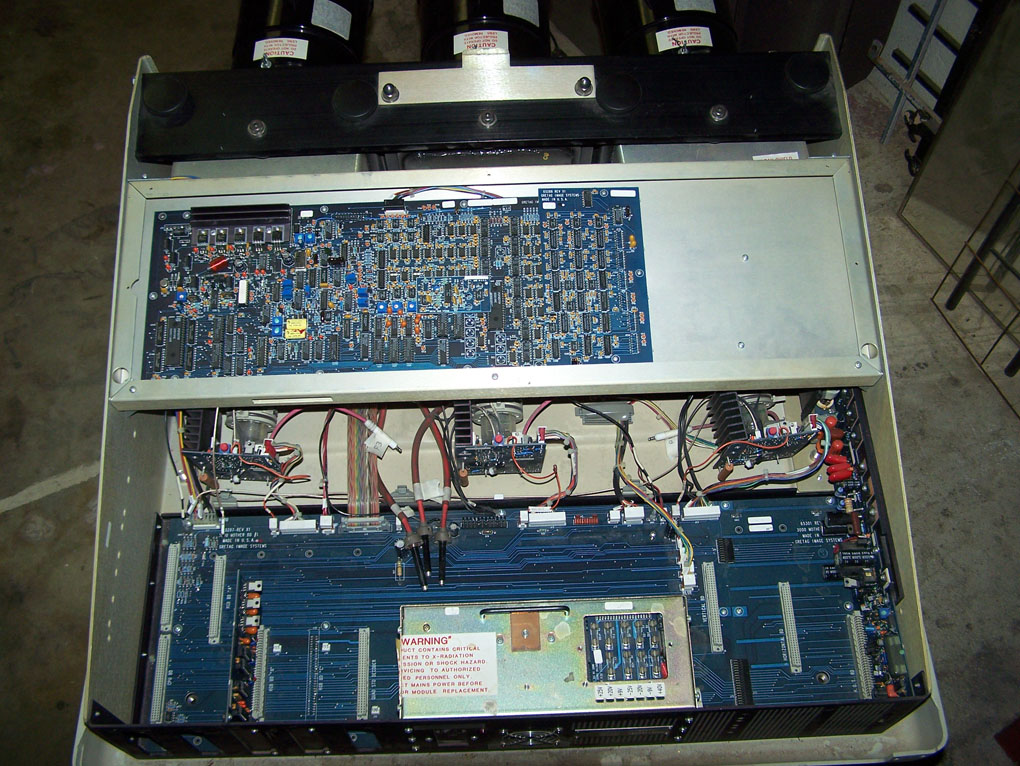

Hello All,
I made a few posts on the AVS Forum at the end of 2002 trying to sell my pj, thankfully that never happened. I got it setup in my apartment during 2004 and it looked great on my 200 thread count 100% cotton screen. It only lasted for about a month before it died though. All the LEDs on the LVPS were bright, nothing smoked, popped, or sizzled, just no glow in the tubes. I knew that the HVPS had a bad rep and not being an EE I settled back into the eye straining world of a direct view tube. Four years down the road, the doctor told me to stop thinking about reality and get a hobby, my wife said sell it or fix it, so here I am.
Before I get started. I would like to thank all the gurus who have helped keep these machines running for so long.
The plates on the back label it as: Esprit/Ampro Model 69196, SN: E4000D13901, as well as Gretag Image Systems Model 69196 (4000D). Based mostly on the mounting of the registration board here(link), and this board (link) underneath it, I wonder if the pj might be modified. What do you think? What is the board (that I wil rehang) hanging precariously underneath the registration board? Is it the Registration Amplifier Board?
Here is a list of the major components:
Gretag Hybrid Registration Board 65229 Rev X3
Gretag Registration Amplifier Board ? 65248 Rev A
Gretag Yoke Board (3) 65227 Rev A
Gretag 3000 Mother Board #1 65297 Rev X1
Gretag 3000 Mother Board #2 65301 Rev X
Gretag Test/Text Interface Board 65274 Rev X
Gretag 1535/1700/2000 RGB Board 65246 Rev A
Gretag CPU Board 65236 Rev A
Gretag 1700/2000 H.O.T. Board 65277 Rev X1
Gretag Quad Standard Decoder 65238 Rev A
Esprit Vertical Board 65298 Rev X1
Esprit Neck Board (3) 65302 Rev X1
Esprit 2000/4000 Horizontal Board 65245 Rev A
Sony SD146A Tubes
Ive pulled the HVPS, opened it up, and tested the diodes and resistors. Looks like three rectifiers in addition to most of the resistors are bad. Thurman Witte has mentioned that NTE parts did not work well for him. Before I order replacements, any recomendations.

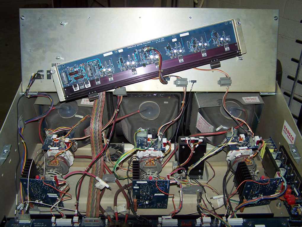

The registration amp definately came from a different model. It looks alot like a Model 2000 style with the clips on the heatsink for attaching to a round bracket. Not too big of a deal as the 2000 and 4000 chassis are the same other than the size difference between 7" and 9" tubes.
Did you try running a "30 code" while the projector was in one piece? If there were HV problems the remote would display that. It would be to your advantage to determine if the HV is even running before you start changing parts.

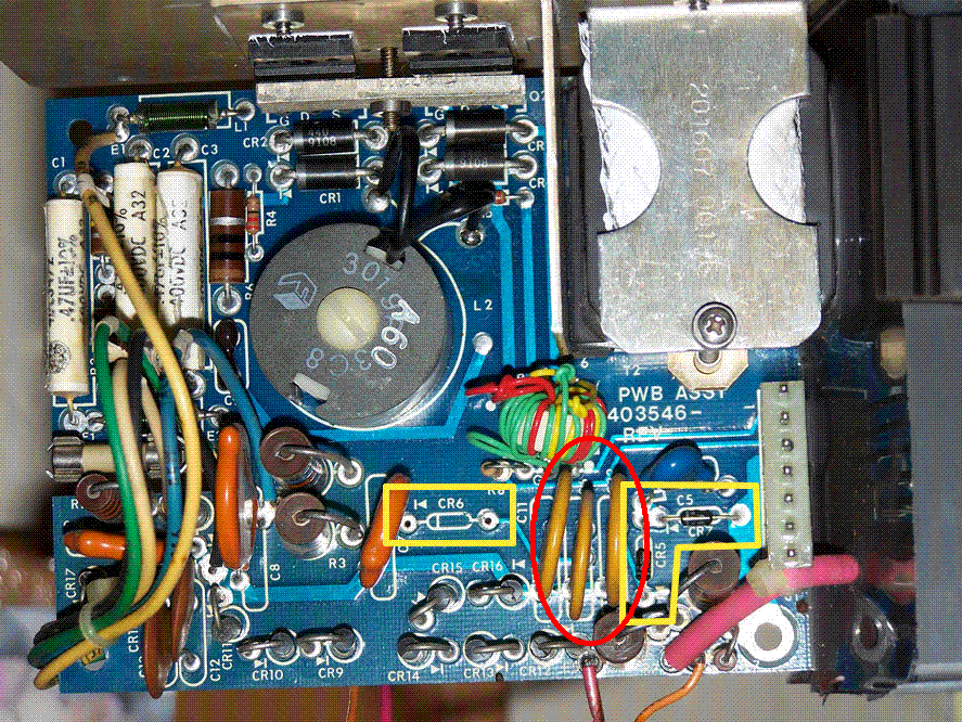

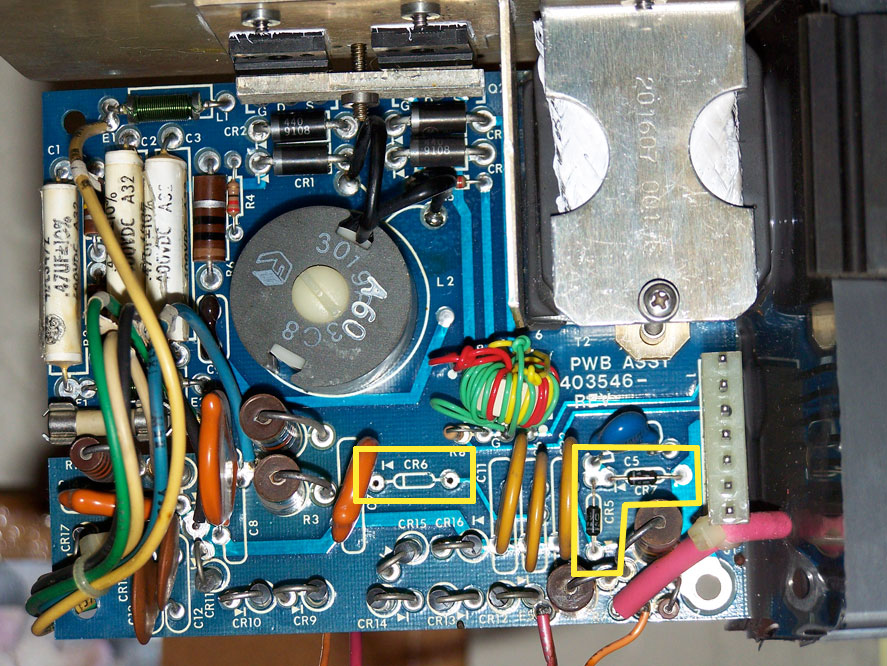

In the past you said the following regarding a 4000G HVPS: "All of the diodes along the edge of the card that have been known to cause problems with this supply tested OK. Working your way inward, you will see diodes CR5, CR6 and CR7. All three were open in both directions. There was no visible sign of overheating of these. These three will be replaced with a slightly higher spec NTE558."
Did the NTE558s work for you?
What parameters did you increase in choosing the 558?

Holy crap, where did you find that post about the diodes. That must have been 4-5 years ago. I don't even remember it.
What ever I did to fix that HVPS, it's still going strong. You might wish to test those big resistors next to cr5 and cr7.

Posted: Sun Oct 05, 2008 11:06 pm    Post subject:
The rectifiers are HV type with several juctions in series. They will probably check open with regular diode check. The part number is NKV3FX and the spec sheet stated VF=6V. I have found alot more open capacitors in the G-2 and +600V doubler circuits than bad diodes. Check the wires that are soldered to the PCBs. They frequently break off.

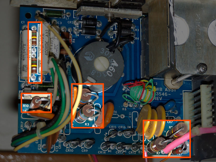

Posted: Mon Oct 06, 2008 1:17 am    Post subject:
Guys,
There is plenty of homework to search in the AVS Forum Archives. It was Chip and Thurman got my screwdriver out of the box. I hope I'm not gettin freaky with all these pics, but this one shows the bad resistors. R7 and R26 both test good but since R26 is melting into the pink wire I'll swap them both out. The wires are in good shape. Insulation on the two smaller wires at the edge near R7 are a little browned so I'll take an inch off and resolder them.
Are the G-2 and +600V doubler circuits part of the HVPS (that you have hilited on the gif) or elsewhere in the pj? Do you have a digital version of the NKV3FX spec sheet?

Posted: Mon Oct 06, 2008 1:51 am    Post subject:
For those resistors you can use Ceramic ones instead of the crapy Carbon Composition, On the Marquee power supplies many of us replaced them with Ohmite brand ceramics.

Posted: Mon Oct 06, 2008 11:48 pm    Post subject:
Tim
Yep, the caps are circled. Two are for the G-2, one is for the +600V. The +600V is used by the focus modulator and won't prevent a picture if missing. Open caps, power resistors changing value, oxidized solder on the zener diodes cause low, missing, or ripply G-2 which directly effect the brightness, presence, or stability of the image. All moot points if the main converter section isn't working.
The pdf is the only spec I've ever seen for the rectifiers.
