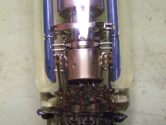

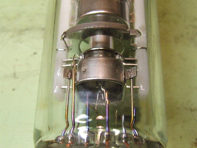

Due to a recent major oopsie I have been looking for a replacement green tube for my Ampro 4200. I had a decent 09MEX laying around so I checked it out to see if it could replace the original 09MI. The pinout is the same, the guns look very similar with the G-1 electrodes being slightly different and with the 09MEX the guns are much closer to the end of the tube. The 09MEX works but the focus magnet had to be positioned about 1.25" farther back from the tube face. The 09MEX looks like it is about an inch or so longer, too. It might work in the 4200 but the extra length might be a problem.
Scott

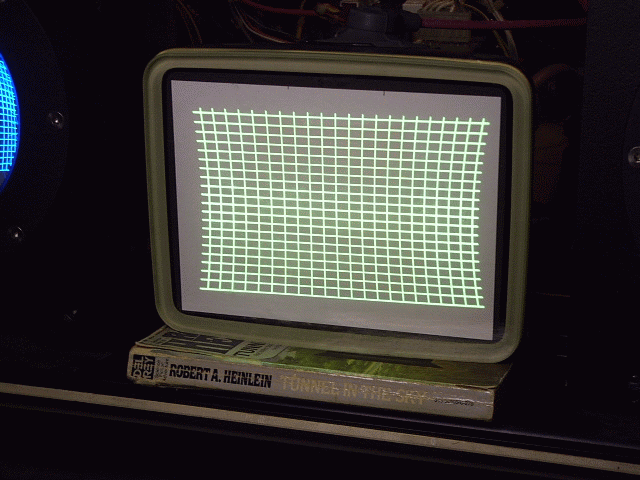

It works. Can't you just feel the X-rays?

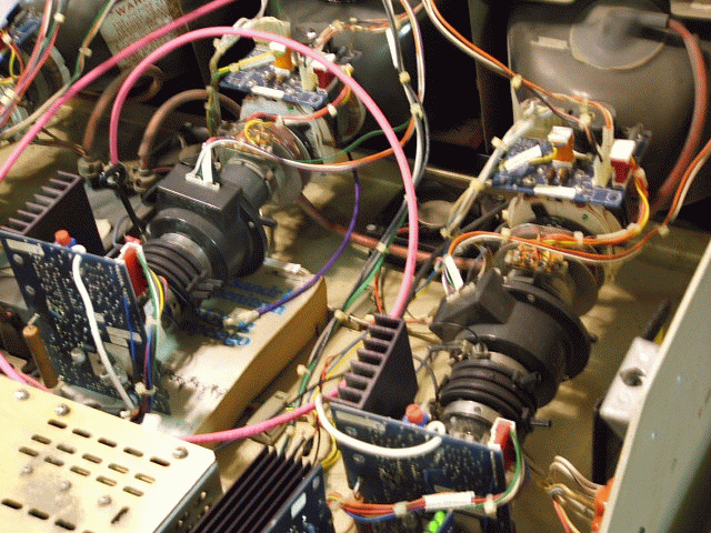

You can see the space between forcus magnet and convergence coil.
