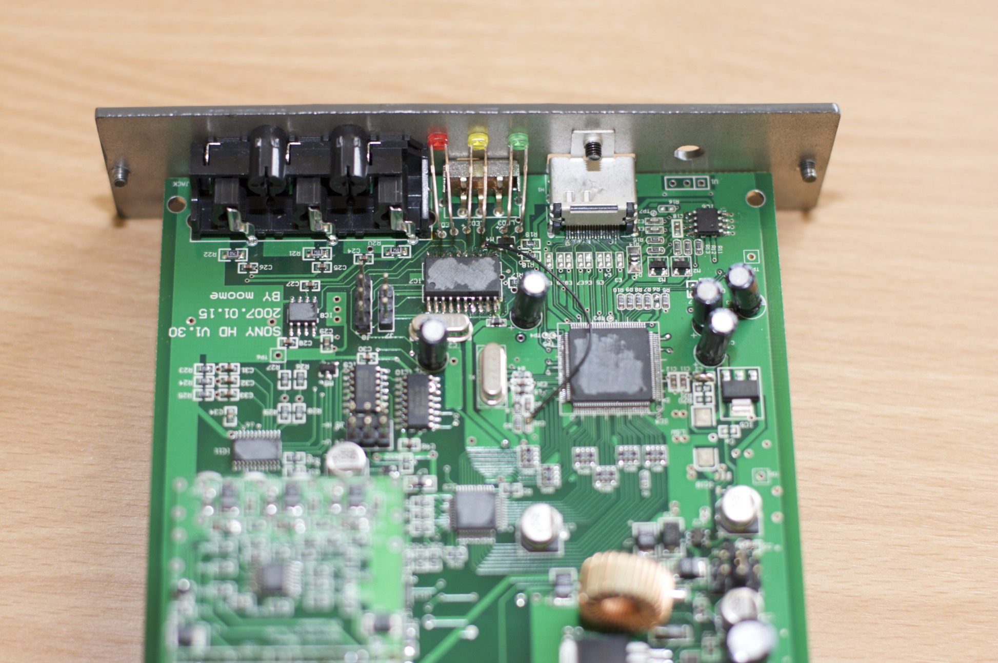

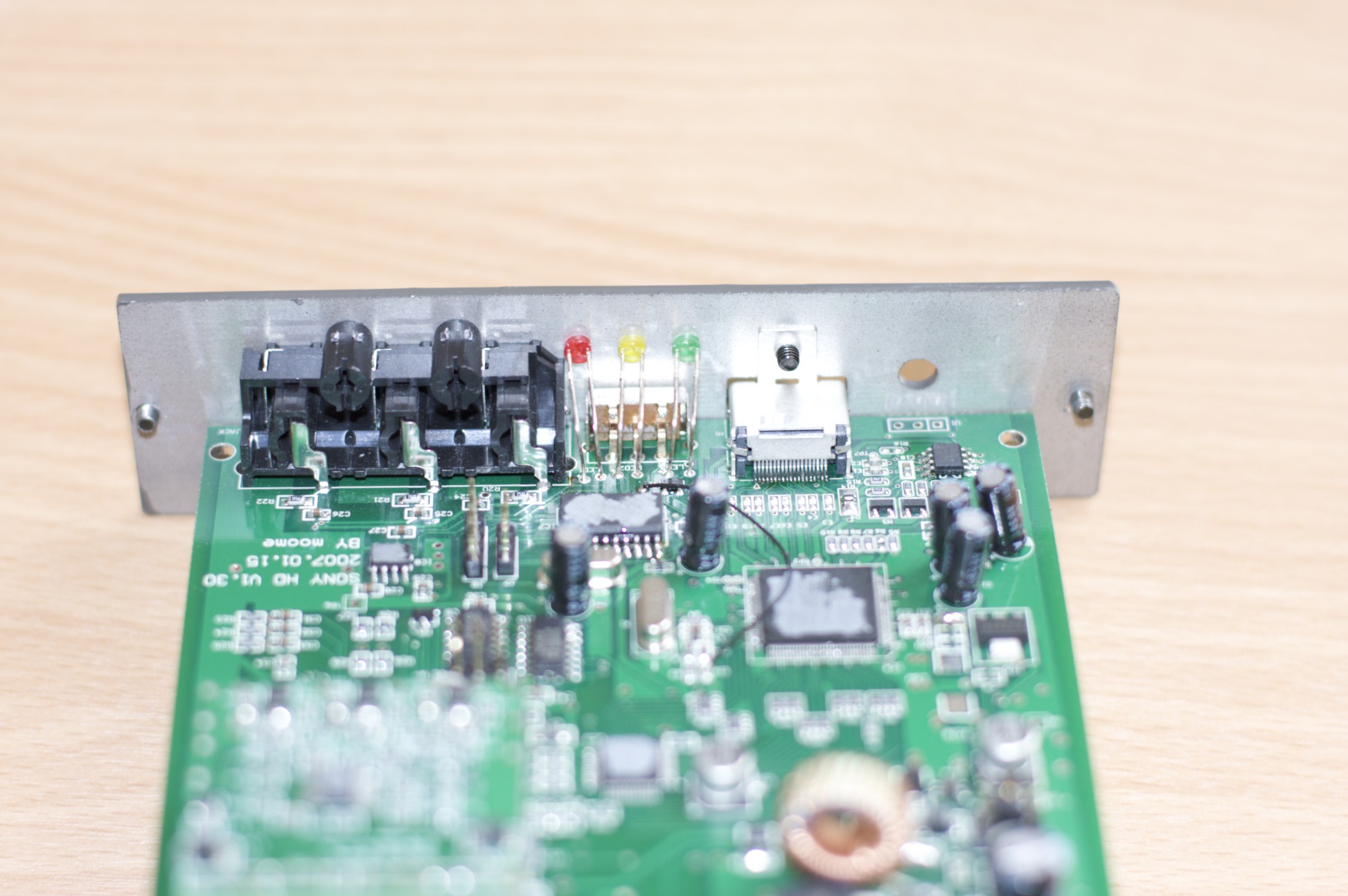

Tyke, the most problem on old version IFB card is HDMI connector, if connector is bad,
you will not able to get HDCP handshake, can you chack any damage on the hdmi connector,
or you can send me a image of hdmi connector's back side. so we can check in on line~

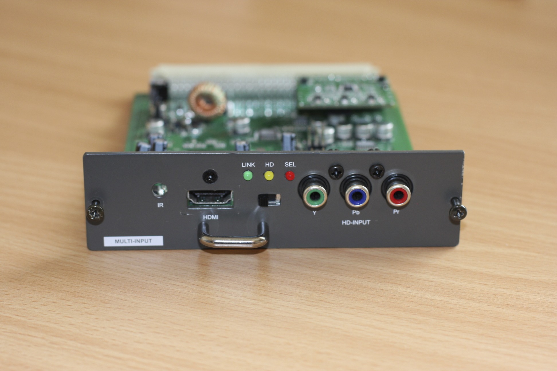

| Posted: Fri Sep 26, 2008 2:06 pm Post subject: Photos as Requested |
Moome, thanks for the quick response.
I have attaches photos as requested, please let me know what you think is the problem, as I previously stated, you had this card back for repair less than a year ago.
Are there any other tests I can do to identify the problem?
Darren

you can check how many LED light up on the card, when you select the card, the red LED should up, and when press remote the yellow led should blinking, and when receive the hdmi signal, green led should keep on, if not, the major problem will be connector~

I have the red and green lights when the hdmi is connected, but no picture.
