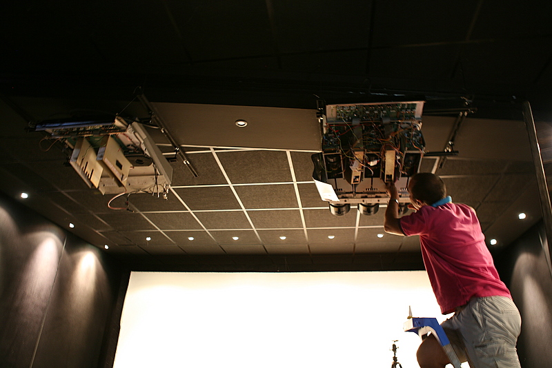

The beginning...
We need to move these projectors back!

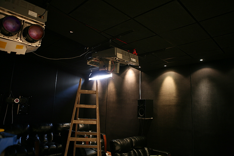

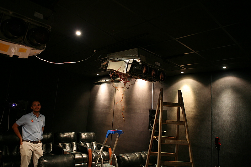

Tubes pulled down... Unfortunately, the ceiling mount was too well constructed to make sure nothing fell down, so it made it very difficult for us to move the chassis, but we did it after 2 stressful hours, which included one of the projectors nearly falling down with the tubes still present! Shocked

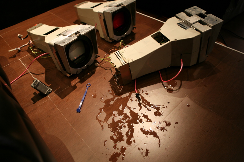

Next problem... glycol leak! Thumbs Down

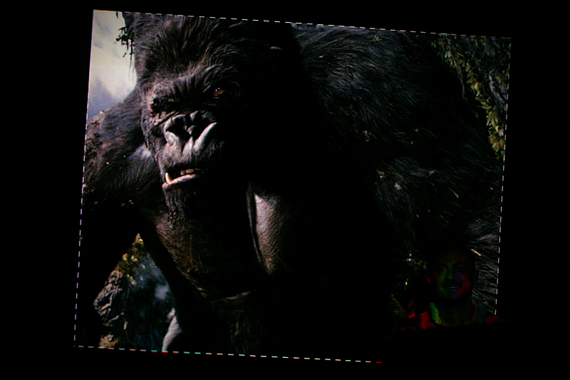

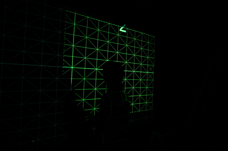

7 hours later, we have done a very nice job on full mechanical setup of one 9500. This is me converging on top of his digital pj... at least they are good for something!
 Filesize:  132.84 KB
 Viewed:  7915 Time(s)

Finally, one CRT down, another to go tomorrow. This one is dialled in very nicely, just need to do grey scale calibration then tweak convergence. We have this singing at 1080p72, contrast 75, tightly focussed corner to corner, and zero banding! Andres has never seen his 9500 look so good. We watched just the right side of some demo clips for an hour without any audio, just marvellling at a job well done.
