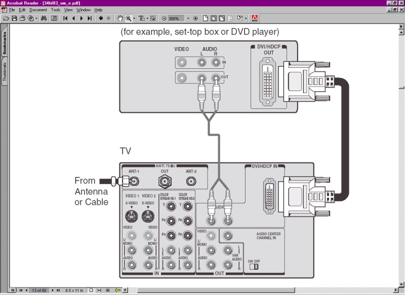

Strange in the manual it's listed as HDCP on the DVI input. (See fig.1 below.)
However in this forum they say it's not.
"...i also want the DVI-HDCP input so i can use a 1080i DVD player someday... Are there any other models out there with this? (Yes, the Toshiba 34HF83 has DVI input, but it is NOT HDCP and will not accept the 1080i output from the Samsung DVD player, instead it pipes it out at 720so I've read)

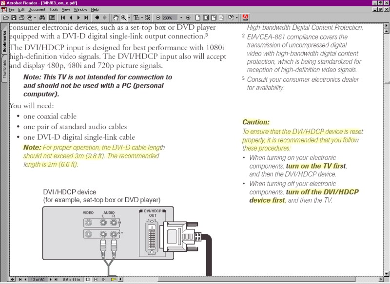

However I'm curious as to why the input's listed as HDCP yet doesn't work. How long is your DVI cable and what brand is it? In the manual it calls for a 2m (6.6foot ) cable as the recomended length. It may be a handshaking problem between the Motorona and the Toshiba. Follow the directions in fig.2 below.
Turn on the TV BEFORE the Motorola box. See if that will give you a picture.
fig.1

fig.2
 Filesize:  115.46 KB
 Viewed:  16508 Time(s)

Notably the Toshiba manual specifies that when the DVI input is being used then for the HDCP to function correctly the TV must be switched on before the DSR-500 and switched off after the DSR-500!
