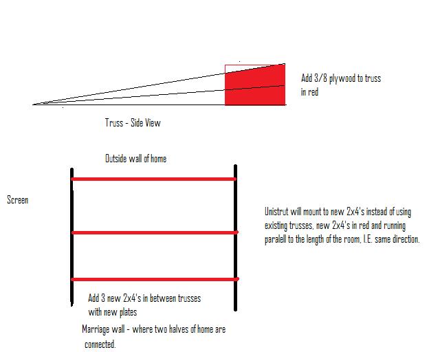

I will also post some pictures of the challenge I am facing in mounting this thing properly.
I have contacted my engineering buddy and he is guiding me through the process.
It seems I will need to slap some 3/8 plywood to the sides of the trusses, this will make the truss in effect a sheer wall, keeping it from pulling apart at the bottom from the weight, then I will span the 24" distance between the two trusses that have now been made into sheer walls, then I can mount the "what the hell do you call those things" u-channels "unistrut" to those 2x4s's and all should be well.
Now then, who knows where I can get the inserts that let the rods swivel in the unistrut? Anyone?

I need any and all suggestions on how best to mount this thing, I am thinking the following.
1: Unistrut with swivel inserts to overcome the tilt of the ceiling from left to right across the width of the room.
2: Eye bolts with hooks and chains
I really need you help guys, she said yes and I want to get this done before her mind changes again!
Many Thanks

Posted: Thu Sep 04, 2008 9:54 pm    Post subject:
If the locations will work, why not put some 2x4 stringers on top of the trusses and just hang from that? You could then hang all-thread off the stringers, suspend some nice painted black unistrut from that, and hang the projector on the unistrut. If you made the unistrut members slightly oversized, you could even slide the projector toward/away from the screen slightly.
If you have a drill press, you could easily match the ceiling angle in the drilled holes in the stringer (to remove the "swivel issue"). You'd also have full adjustability to perfectly level the unistrut by the bolts on the end of the all-thread in the ceiling.
Much cleaner than chains.
If that's as confusing to you as it sounds to me, I can sketch it up for you.

Posted: Thu Sep 04, 2008 9:57 pm    Post subject:
Ecrabb,
WHAT?
Yes please sketch it up, and I will be ever so grateful Laughing

unkyjoesa
Joined: 13 Dec 2007
Posts: 84
Location: Marion TX
Posted: Thu Sep 04, 2008 10:01 pm    Post subject:
P.S The reason for the new 2x4's between the trusses is they are only 2x2, the engineer is afraid the thing is not meaty enough for lag screws, that is why he is recommending 2x4's between the trusses, the lag bolts will go into the 2x4's.
The plywood down the side of the trusses with in effect make the truss a wall "a sheer wall as he calls it" all tied together so the downward force is transferred across all the truss members. "Just in case I wasnt clear on that before." the trusses run left to right across the width "not the length" of the room.

unkyjoesa
Joined: 13 Dec 2007
Posts: 84
Location: Marion TX
Posted: Thu Sep 04, 2008 10:20 pm    Post subject:
Here is a rough drawing of what I am talking about.

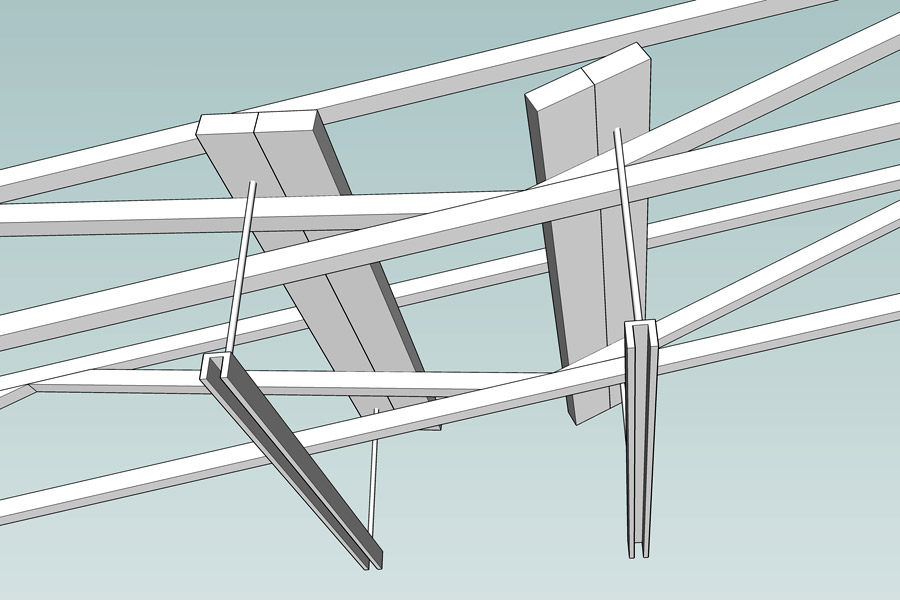

Posted: Thu Sep 04, 2008 11:00 pm    Post subject:
unkyjoesa wrote:
Please visit my pictures here and look closely at my issues with mounting.

Posted: Thu Sep 04, 2008 11:11 pm    Post subject:
That would work. This is what I was thinking. Nothing but some all-thread sticking out of the ceiling. Change or ignore as you see fit.
Idea...

Posted: Thu Sep 04, 2008 11:15 pm    Post subject:
Ecrabb,
You ingenious bastard Thumbs Up
Let me send this to my engineer and see what he thinks.
Wait a minute, why didnt he think of this, oh yeah, I am not paying him.
MacGyver, no hard feelings man Mr. Green

Posted: Thu Sep 04, 2008 11:41 pm    Post subject:
You'd probably still want to use some small pieces of plywood to tie the truss members together to create a gusset plate at or near the point where the new "stringers" sit on the trusses. You're only talking 50-odd pounds per connection, but I like to over-build everything when it's easy to do so.
Oh, and the second 2x4 is just some blocking to keep the stringer from sliding down the trusses... Just a single wood screw to hold them in place on the truss.

Posted: Fri Sep 05, 2008 5:44 am    Post subject:
Nice picture, what did you use to create it?

Posted: Fri Sep 05, 2008 4:17 pm    Post subject:
Google Sketch Up Pro, Gino. It's AWESOME. The best part is that there's a free version with all the functionality that most people would care about.
